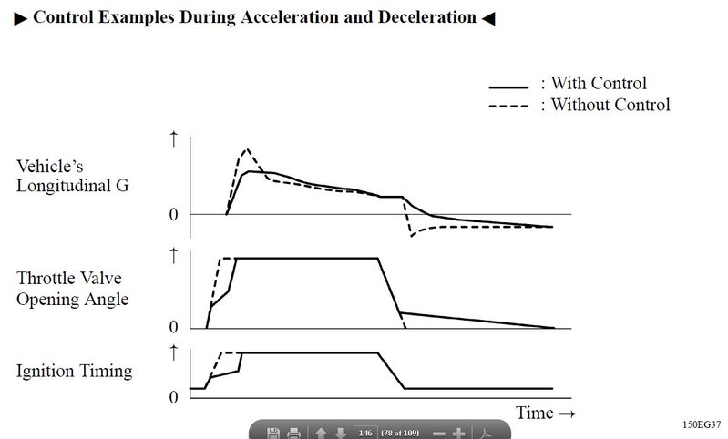

    This "softening" of throttle input (seen here from @tacitos pdf link) may explain a small portion of "butt dyno" that says the engine doesn't feel strong, even if it puts down good numbers. Basically, what this says (if I am understanding it correctly), is that when you MASH the throttle HARD, if actually denies you some of the initial requested throttle input, and eases you into full power over a short period of time. This affects the derivative of acceleration (how fast you are changing your acceleration...also known as "jerk") and numbs it so the vehicle doesn't lurch as hard when you stab the throttle.
    Not sure I am a fan of this. Will have to drive one soon.
    I really wish there was a scale on the "time" axis.
    Addition educational link before someone tells me I am full of shit:
    https://en.wikipedia.org/wiki/Jerk_(physics)
