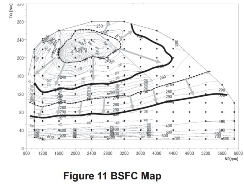

    Let me know if i got this right: It looks like your sweet spot for bsfc maxes out at about 3100 rpm, so while acelerating you should try to shift by 3100 rpm to maximize fuel economy?
    It also looks like there is a fat sweet spot (large load range) between 1600-2400 rpm. So this appears to be the best cruise rpm under most conditions.

    This is the dyno chart? Looks more like a topo map. Is there a dyno chart that looks like every other dyno chart out there? And please, while I thought the penis dyno chart was funny, it gets posted way too often...
