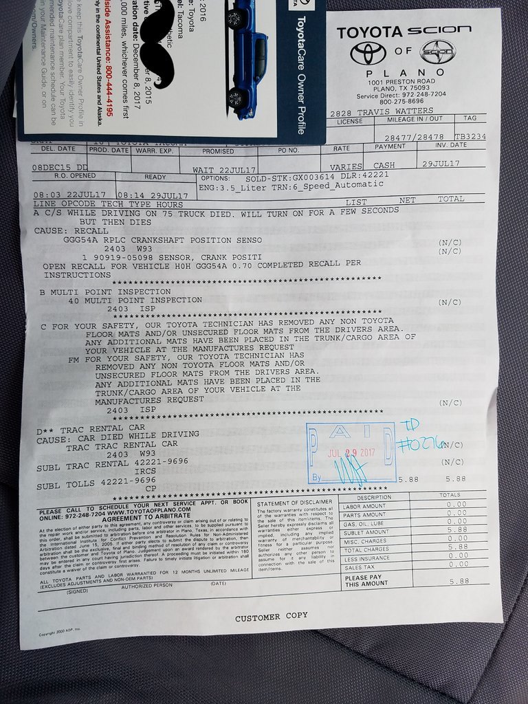

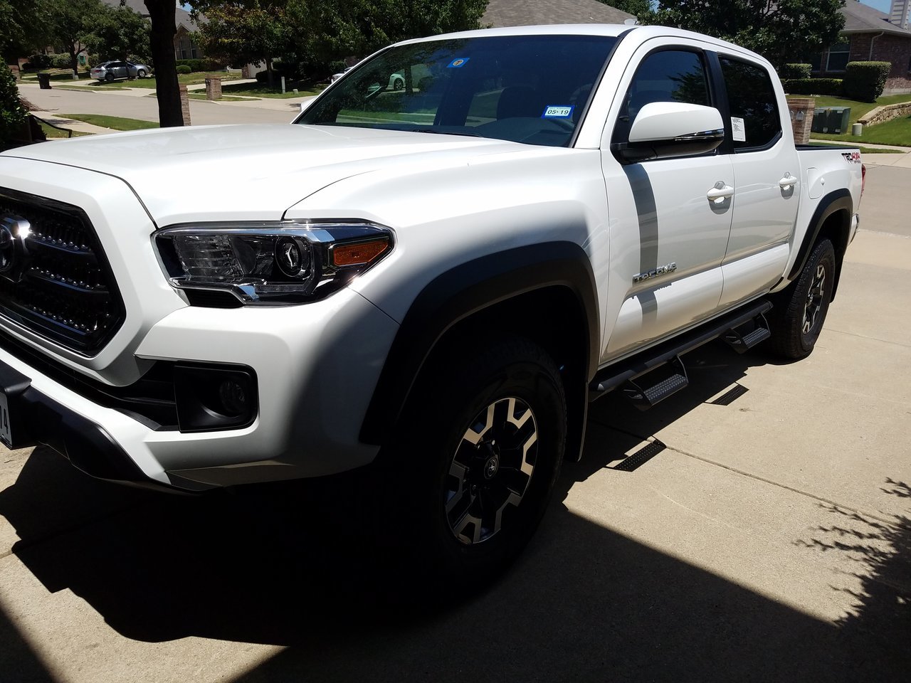

    Got the loaner taco.
    Will hear from my service adviser when they look at it. So will update.20170722_132359.jpg

    You got lucky and got a decent loaner!! I posted on a diff. thread here for this same issue. My truck died on the interstate a few weeks back & left me stranded waiting for a tow. Dealer told me it was due to this CPS issue, but at the time there was no part/fix issued. I got put into a Corolla and told my truck was going to have to sit until Toyota released the part/fix, no one could tell me how long it would take. I was pissed! Was as nice as possible to the service manager at the time, but couldn't believe what they were telling me until I called Toyota corporate. Was basically told by Toyota Corp. that I'd just have to wait it out, the best they could do is improve the loaner (which still hasn't happened).

    Got my Taco today, drives and sounds great.
    CPS was the problem.
    Codes were generated by default.
    The experience was no fun, but they covered towing and rental truck for 1 week.
