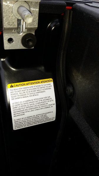

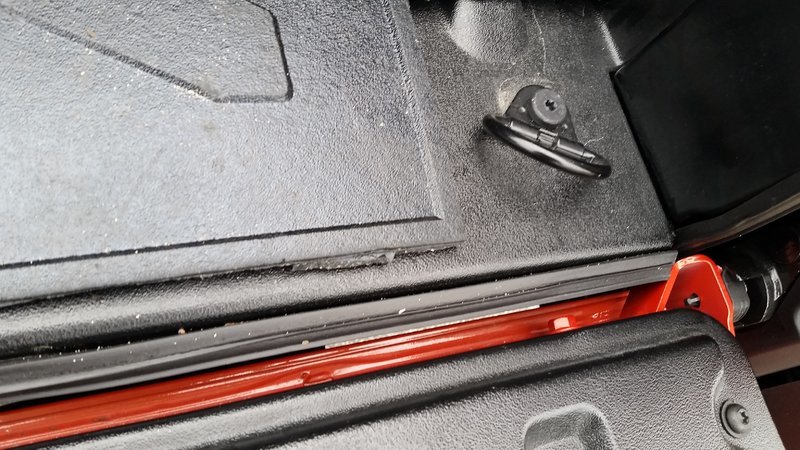

    Installed my Fold a cover last night. Install was fairly easy. I'm not a very mechanical person, and only ran into a few issues. Was missing 2 split washers, no big deal, a trip to Lowes solved that problem. The wind seal rails were a little tight and I needed to put them in the widest position for the cover to close. The only real trouble I had was getting the back cover to close completely. After adjusting the latch and striker bolt it still wouldn't close without some force. I was hoping that the once the seal on the front end took shape the problem would be solved. I made sure the front seal wasnt folded under after closing it and applied pressure to the front door in order to close this. I let the seal sit overnight and take shape. Next day went out and the seal now properly conformed to the truck. The front door closes just fine. The front seal was preventing the door from closing perfectly, but once it flattens out its good. Will update with waterproofness after our first good rain or when I get a chance to wash it.

    Anyone have any pics showing where/how they placed the tailgate seal?

    Directons were a little confusing, but I believe I installed as directed. My pictures hopefully show better than I can describe.
