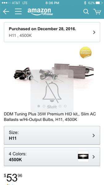

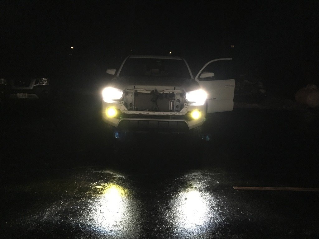

    I don't believe we need the canbus system as the Taco doesn't recognize if a headlight is out. I can verify this because I just did the Morimoto Elite kit which taps only one of the factory headlight circuits to trigger the light relays. If we had canbus the system would see no signal from my passenger side factory light plug not being hooked up.
    As for the H11 vs. H11B - its about the "notches" in the bulb and how they affect the placement of the HID bulb return wire. Here is a good video:
    TRS/Morimoto does a good job marketing the H11B. Others do not, but according to their video H11B is most common, so I would assume most companies offering H11 kits are shipping H11B bulb. However, I cannot verify that.
    Here is my setup (TRS Morimoto Elite 6500K bulbs with 50W Ballast and Morimoto XB LED Fogs):
    FF8A5FF5-9A71-41CC-8445-D986488AA4C1_c05a9a52e45c90ec3a0bfa3c0d77b34b03d5fcd9.jpg 5F9AAA4B-6F22-437B-8084-08997AFE46E4_e0355b087b24efdd43f7e7d373c183bae47d062f.jpg
    panda_taco likes this.
