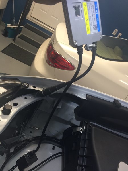

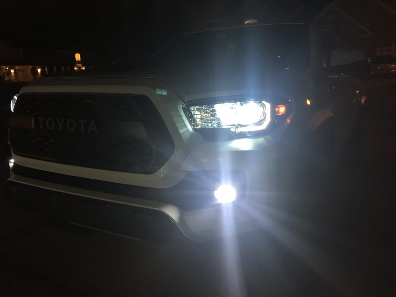

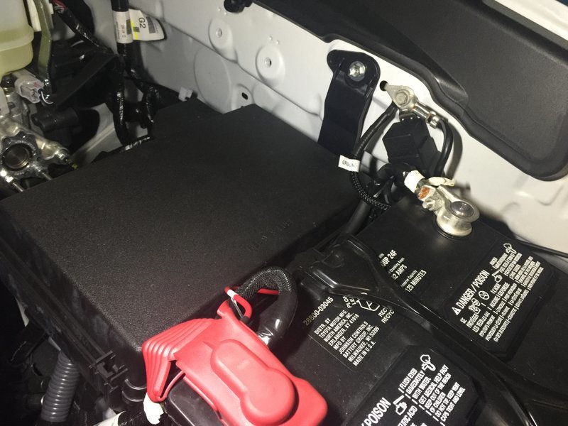

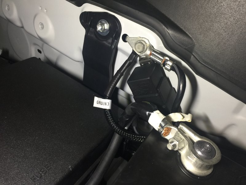

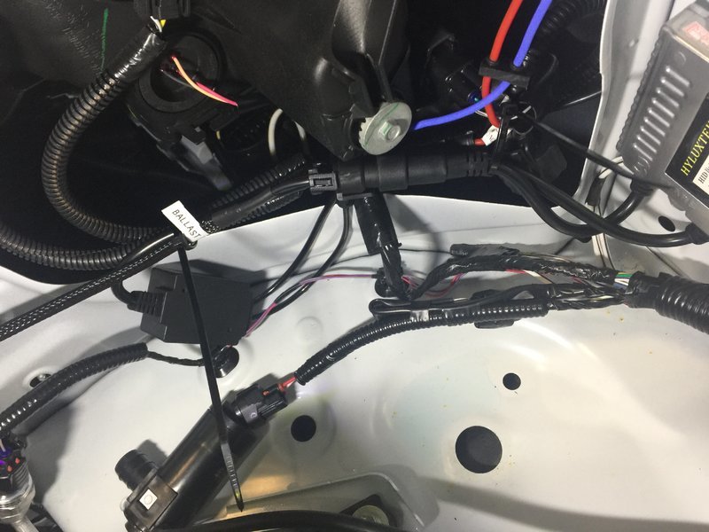

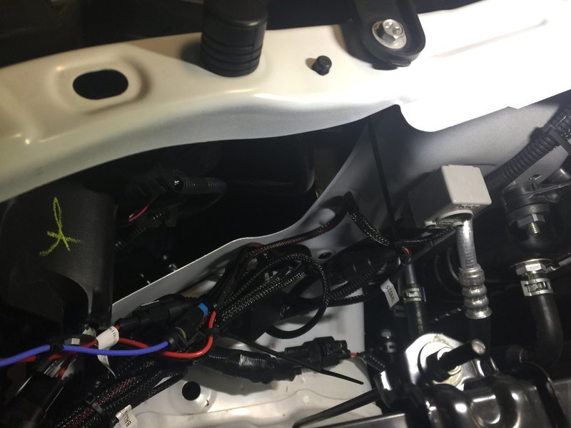

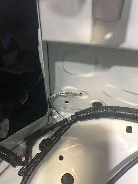

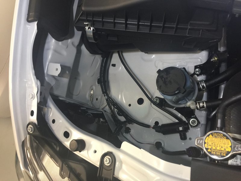

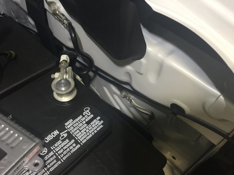

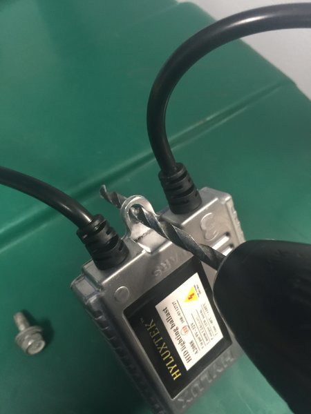

    Big thanks to Scooby24, I finally completed my HID kit with harness install. IMG_1772.jpg

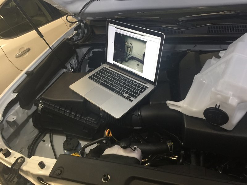

    I had to remove my washer fluid tank because the motor/pump accidentally pulled out form the bottom when I was pulling up on it. IMG_1773.jpg IMG_1774.jpg

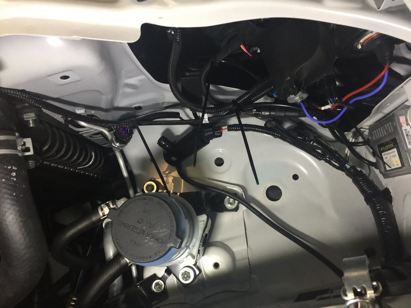

    Once it was out I had plenty of room to bolt up the first Ballast near the passenger side headlight.

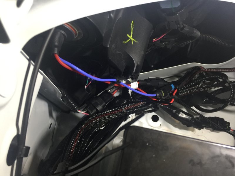

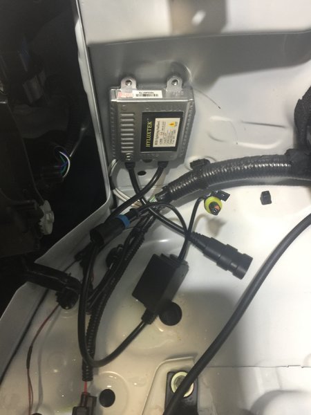

    I drilled out the one of the ballast holes so the bolt would fit threw the hole and bolted it into place.

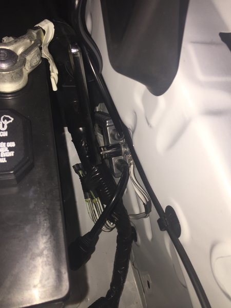

    I moved over to the driver's side near the battery and bolted the second ballast into place after drilling out the hole on this one too. I had to use a small ratchet wrench to het to the bolt.

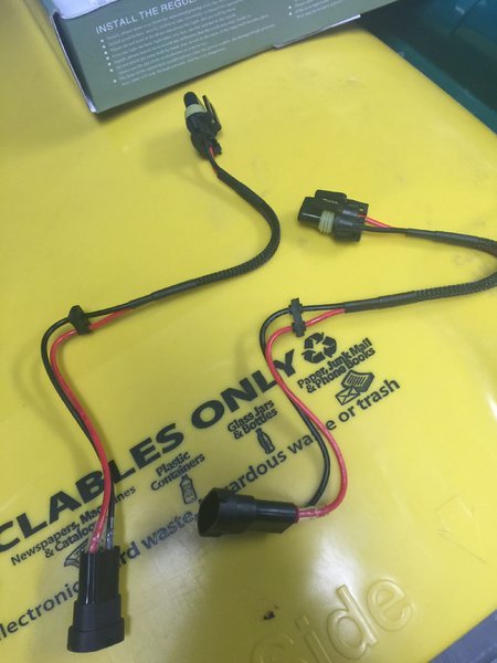

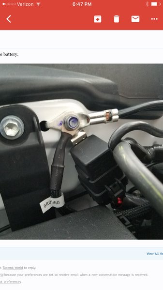

    I separated these two wires form the HID bulbs. One of these will be used later to attach to the "switch" wire coming from your relay and connecting driver side original wire that was plugged into you halogen bulb.
    The bolt near you battery is perfect for connecting the relay's ground wire and relay.
    These photos were taken looking at the driver's headlight after the HID's were installed.
    These photos were taken of the passenger side headlight after the HID's were installed.

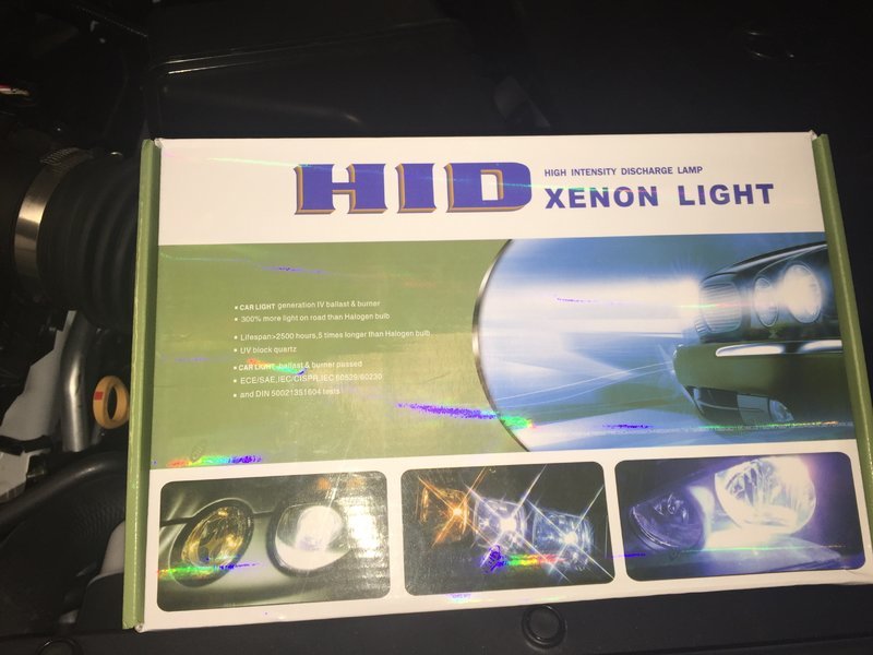

    This is the box that the HID kit came in.

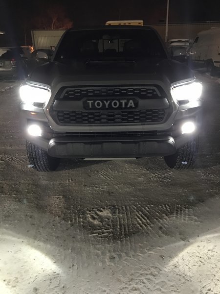

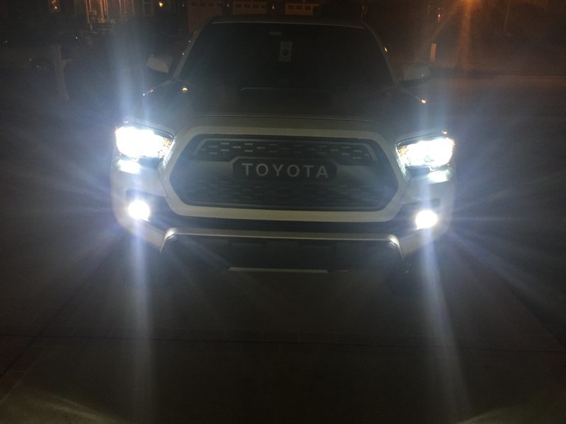

    Finished product with HID's installed. I really like you the color matches the TRD PRO LED DRL's and Rigid Fog lights.IMG_1797.jpg IMG_1798.jpg

    Are you guys all running relays?
  20. Jan 31, 2017 at 12:37 PM
    #180
    su.b.rat
    su.b.rat broken truck
    Jul 30, 2016
    #193316
    9,869
    yessir, Diode Dynamics waterproof, about $30-35. the ballasts draw 20amps on warm-up and the circuit is fused for 15, so the relay solves that.
