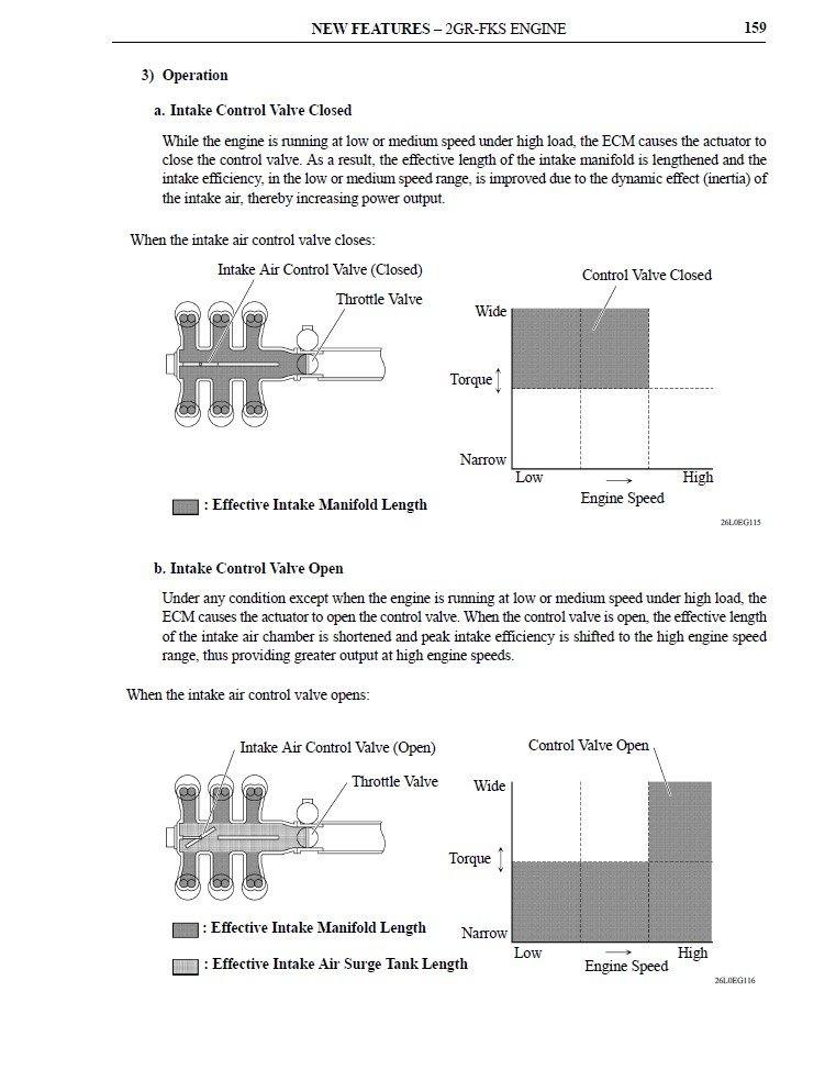

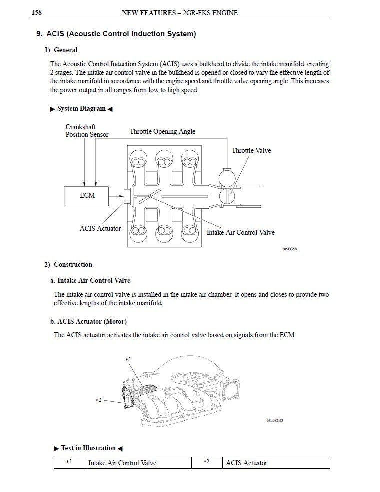

    For those interested in the details of this system:

    Wonder why they name it "Acoustic...control " Did they mean "Actuator controlled"
    What's acoustic about it ????
  11. Apr 2, 2020 at 1:54 PM
    #31
    su.b.rat
    su.b.rat broken truck
    Jul 30, 2016
    #193316
    9,869
    pressure waves. that's what it's all about in the plenum regarding tune controls.
