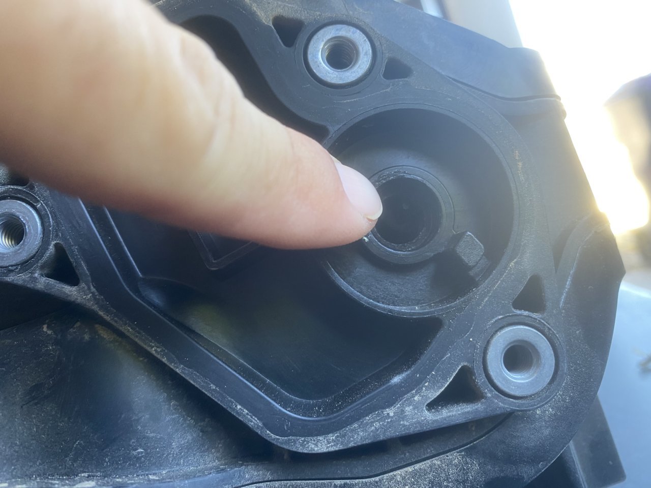

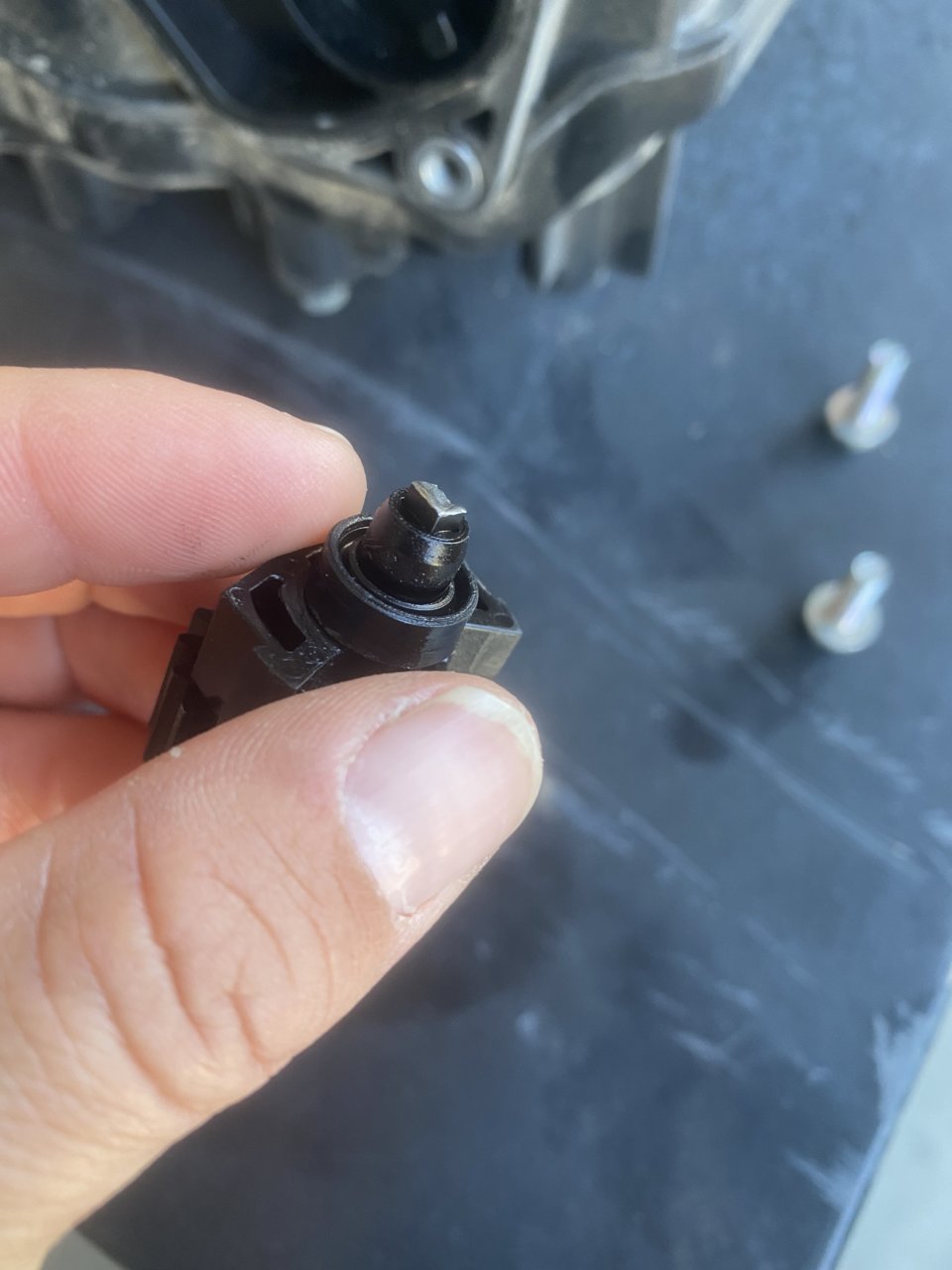

    Vehicle drives fine as long as I drive like my grandmother on the road, As soon as I want to go faster to pass someone on the highway or to get on the interstate the motor will go straight into limp mode and I would have to pull over and turn off the truck and start it back up again. After that the truck will run just fine as long as I drive like a normal person. lol. I have a code reader and at first it read that I had a misfire on the cylinder 5, I did some research and everything I could find said that it was most likely the crankshaft sensor. I ended up replacing all three coil pack's on cylinder 1,3,5. I replaced all of my spark plugs. I cleaned all of my injectors(watched a video on youtube about that one). After replacing all of that I figured it was fixed but no, Code is now reading only cylinder 3 as a misfire, saw this post and took off the intake pelleum and to my surprise mine too is broken.

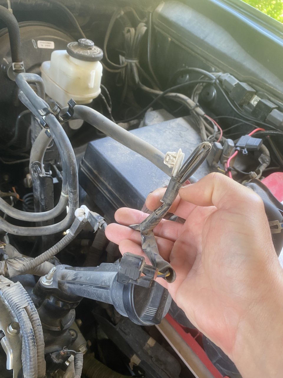

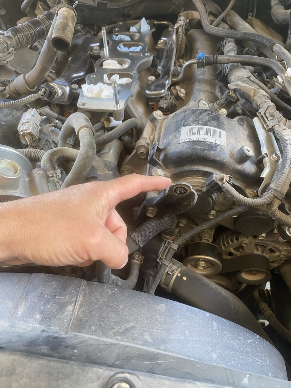

    I'm an electrician by trade, I dabble in mechanical work a lot. This isn't too hard to do, took me like 20 minutes to take it off. Just remember too unplug the little harness in the back before you take off the pelleum.

    Hope these picture's help!
