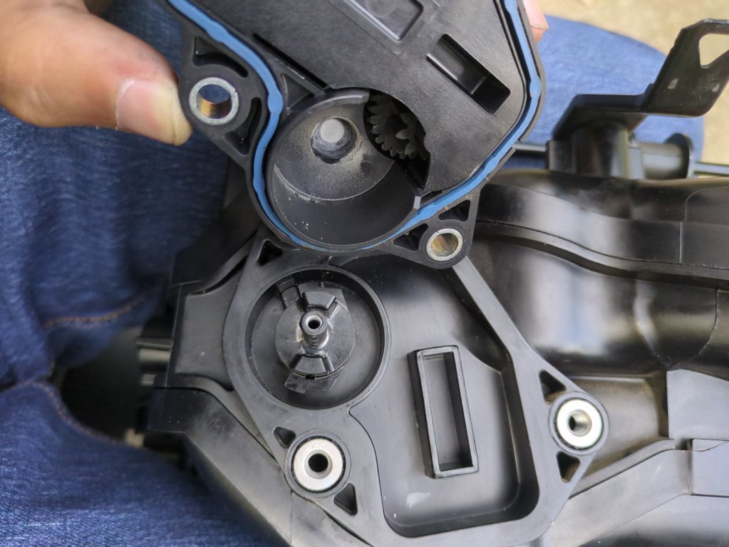

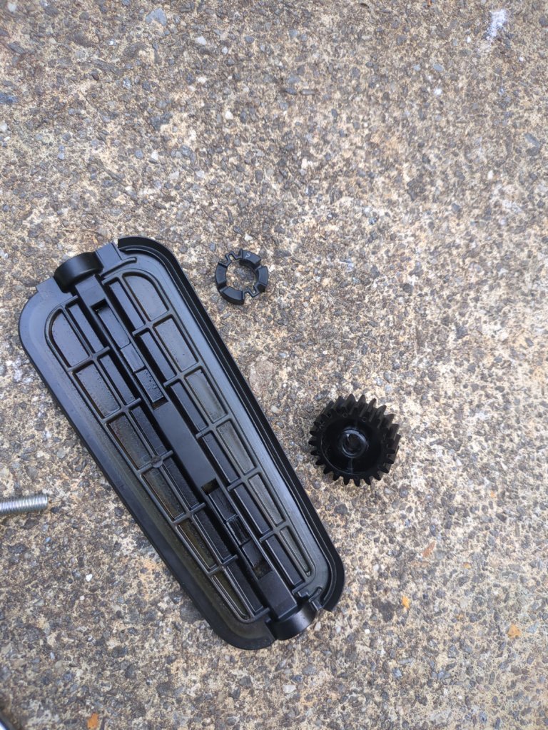

    Here's what I'm going to do since I can't get the bearing out. I'm removing the flap and the gear. Reinstalling the shaft back into the bearing. This should prevent the bearing from falling out and the shaft shouldn't move so that shouldn't break on me either.

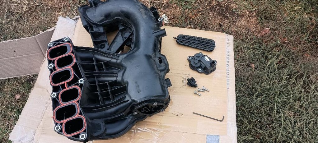

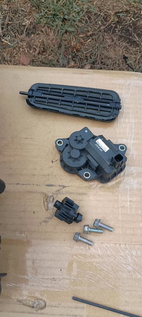

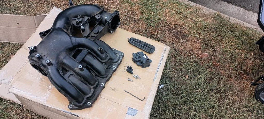

    Yep this happened to me, running my truck up hill or over 4000rpm would make my truck go into Limp mode, after changing spark plugs, crankshaft sensor, cat sensors etc. but didn't fix the problem. I researched more and found this page, so using this video.
    I removed the intake and shook it and heard the flap rattling inside. realizing I finally found the problem.
    I find mind boggling that something as small as an actuator flap can brake but can't be repaired or replaced, and one would have to purchase the whole upper intake manifold plenum that brand new will cost $900 at the dealer and $650.00 at third party sellers.
    so I hope this helps anyone with this Upper Intake manifold ( Toyota 17190-0P101 ) problem.
    I found a used part for $275.00 here
    https://ahparts.com/search/2016/Toyota/TACOMA/intake-329/329/adbag
    Brand new here. $614.00 here
    https://www.toyotapartsdeal.com/oem...(1=2GRFKS;4=SR5;6=6FC;7=DCB;0=GRN305L-PRTSHA)
    watched this step by step video here
    this costed me 314 total and the swap took me about an hour and a half. it was kinda easy, just pay attention to bolts and holes connections, other than that it wasn't too technical.
    hope this helps.

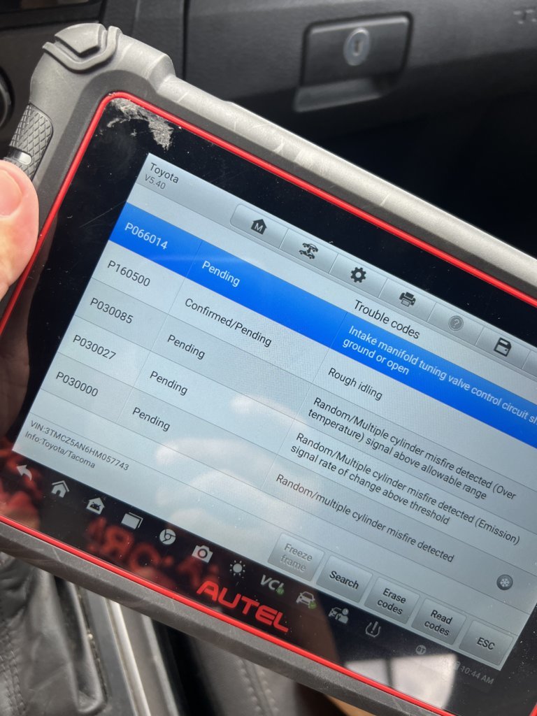

    I might be having the same issue. When I go uphill I hes
    Hey bro gotta ask you something. When you went up hill on a freeway did it make a noise to like something is banging around Inside. If I go down hill my truck is okay but when I go uphill and put her under load I head a rattle like something is rattling inside if I force myself to gas it and next you know boom I went into limp mode (lose power and can’t accelerate) with the same issues as you. Had the same codes. Was wondering if you heard any noise too. But I had multiple cylinder misfires not just one.
