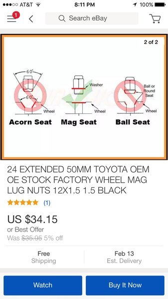

    You can also use these. stock nuts have 12x1.5 tread, mag seat type.
