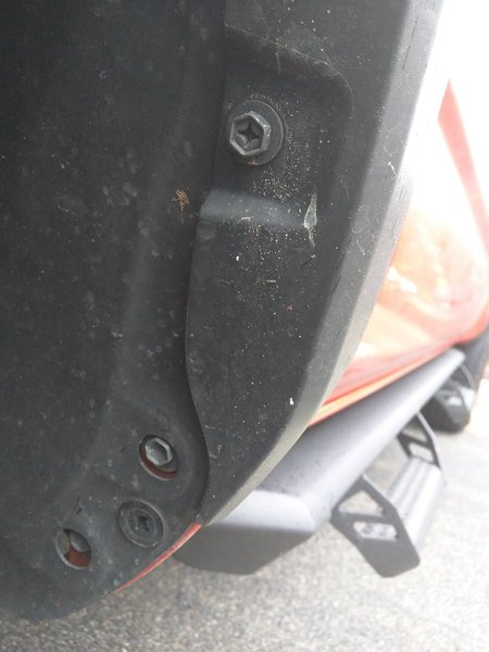

    Try loosing all screws . While holding it snug tighten the lower first , then middle, upper, lower. That might help I have one similar that I have yet to try.

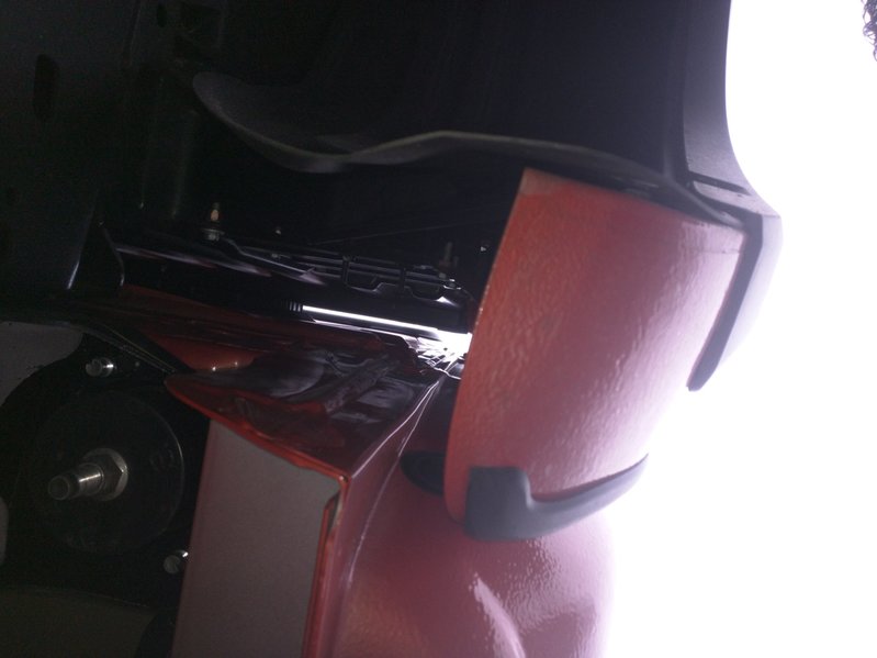

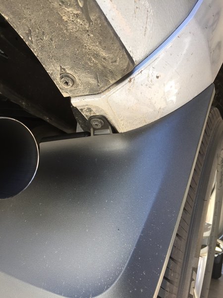

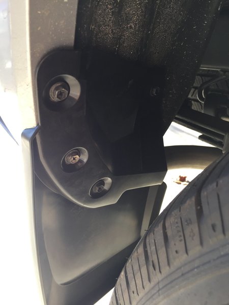

    I tried to install the OEM mudguards but was successful in installing only the front ones. I'm having difficulty installing the rear ones. They rear mudguards have a bottom screw part but there is no place to screw them. I only see three screws on the truck for right/left rear mudguard area. Pics attached. Can someone who installed it please help? Btw my truck is a 2016 TRD Off-Road Double Cab short bed. Thanks.
    Right Rear Bottom View
    Left Rear View
    Right Rear View

    You're making the same mistake I did, you're trying to put them in FRONT of the rear wheel, they fit BEHIND the wheel, they will fit perfectly, when you do that.

    Now it makes sense .. thanks for pointing that out .. :)

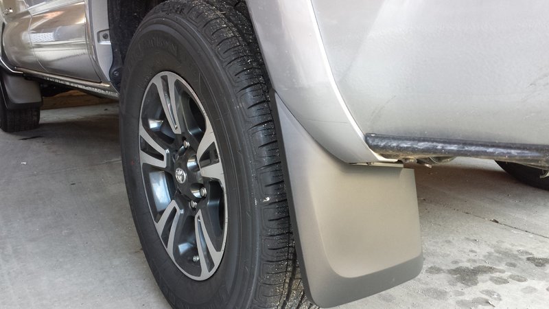

    Here's how it looks with OEM mudguards installed without fender flares.

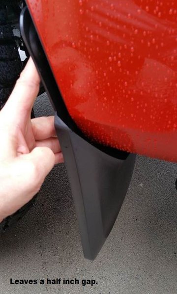

    Ok, I thought I researched everything but now I'm stumped. Can anyone fill me in on which Trucks have fender flares and which ones do not? I don't particularly care for the half inch gap as shown in the previous photo. I've got a 2016 TRD Sport DCSB 4x4 on order. Will my truck have the fender flares or not?

    The only non-flare trims are SR and SR5. Most SR5s have the appearance package which does include the flares.
    Your truck will have flares.
