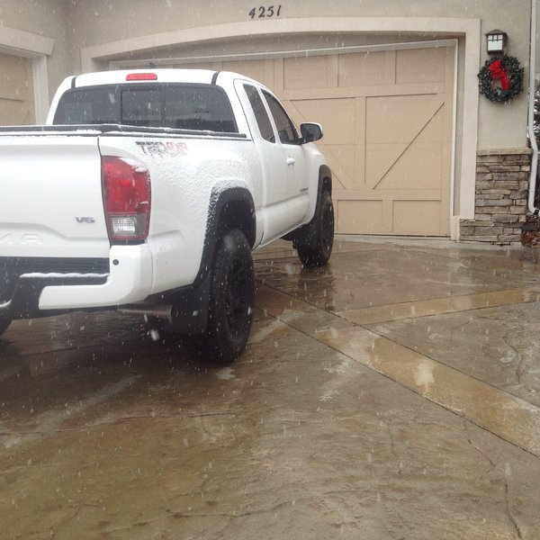

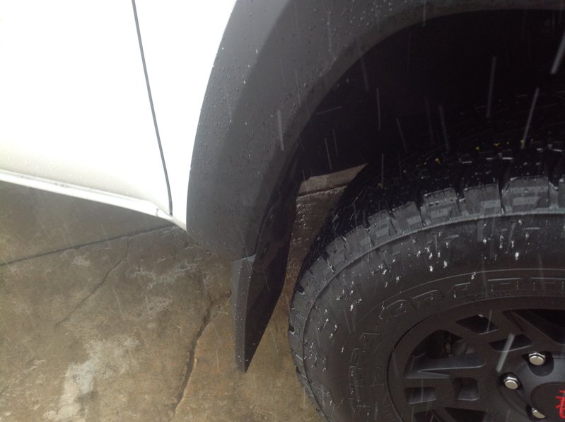

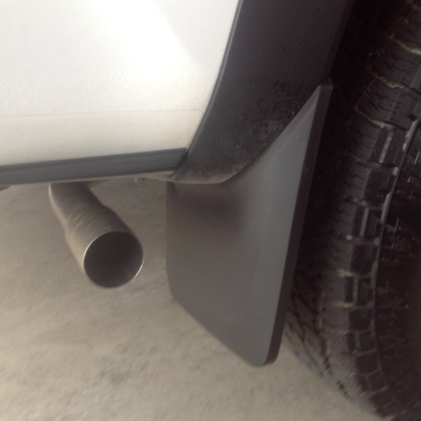

    I installed the OEM mud flaps today. The fit is excellent, no gaps, all of the holes line up easily. It is apparent these were computer designed for the truck. The rear flaps each utilize 4 factory screws, and one additional screw. The additional screw taps into the fender blank. I bought the (4) screws for the blanks at Ace Hardware in the license plate drawer. The front flaps utilize 3 factory screws and one additional. The screws have 10 mm hex bolt heads. You will need a socket wrench. Install takes less than hour. The clearance on my fronts is pretty tight; I am running 265/70/17s. I probably have 3/8 inch clearance of the flap when the wheels are turned 45 degrees. Pics aren't great due to weather... glad I chose OEM.image.jpg image.jpg
