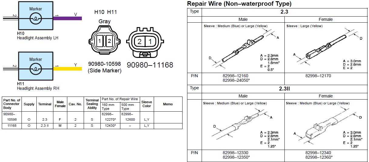

    Are these plugs for the side marker? I'd be interested in the part number also :)

    I received my harness on Saturday and installed my lights yesterday. It worked wonderfully and I couldn't be happier with the new lights. Mike sent me a couple of pins for one of the side marker Dummies and I used it to power up my Raptor lights. Works great! Everything is plug and play, no ugly splices!

    I held off on getting them, but I couldn't resist the opportunity to integrate them into this. I had them in the grill inactive waiting on the harness and I can always unplug them and go back to a dummy connector if I remove them. Helps that I have the tool to crimp the pins.

    Different terminals but same size tabs and orifices.

    I am having a brain fart so I need some help! I have a 2017 TRD Sport and it looks like I have five OEM plugs going into my OEM Headlights but the harness on this thread only shows 4 plugs to connect in to and I even looked at the harness offered by TRS and it also shows only 4 plugs to connect to; what do I do with the fifth plug? I think it's the side marker that I am questioning...Thanks in advance

    I'm with you but still not sure what I do with it! What does everyone do with the side marker bulb plug if there's no connector on the harness for it? It just hangs behind the new LED headlight? I'm not looking to use it for anything else so I'm uneasy about just leaving it! Is anyone capping them or something like that?

    If you bought the harness from xrunnerdude, he includes the mating connector to plug it.

    Ah ok so it just gets capped and that's the end of it...I see now lol. I haven't bought one yet but I wanted to make sense of it all before I pull the trigger...it's gonna be the biggest mod for me so the anxiety and pressure is on!!!
