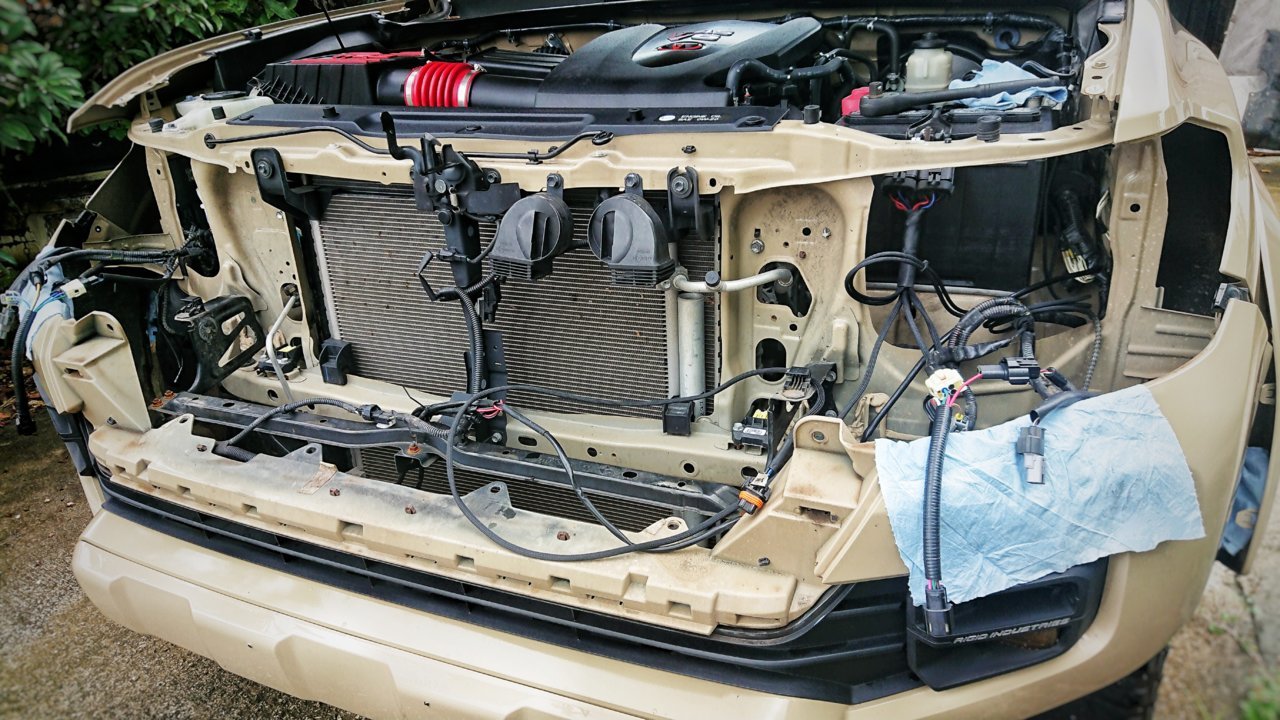

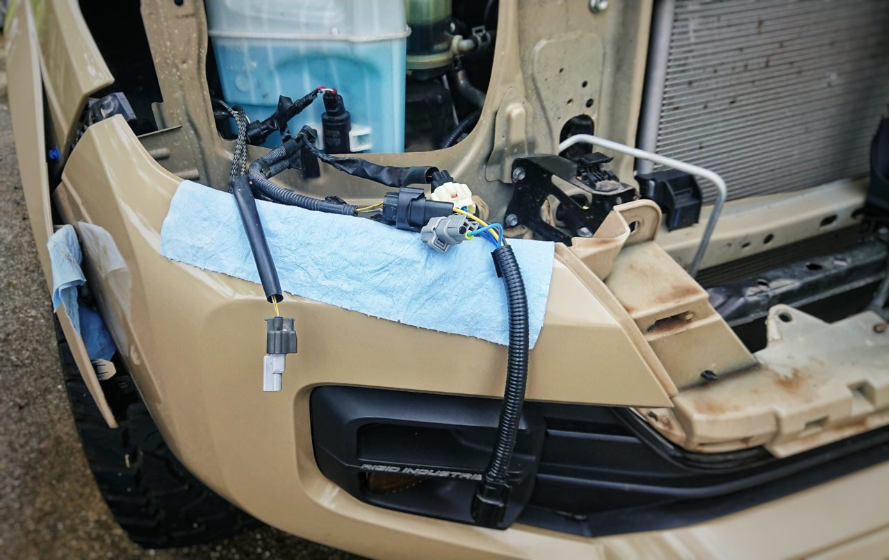

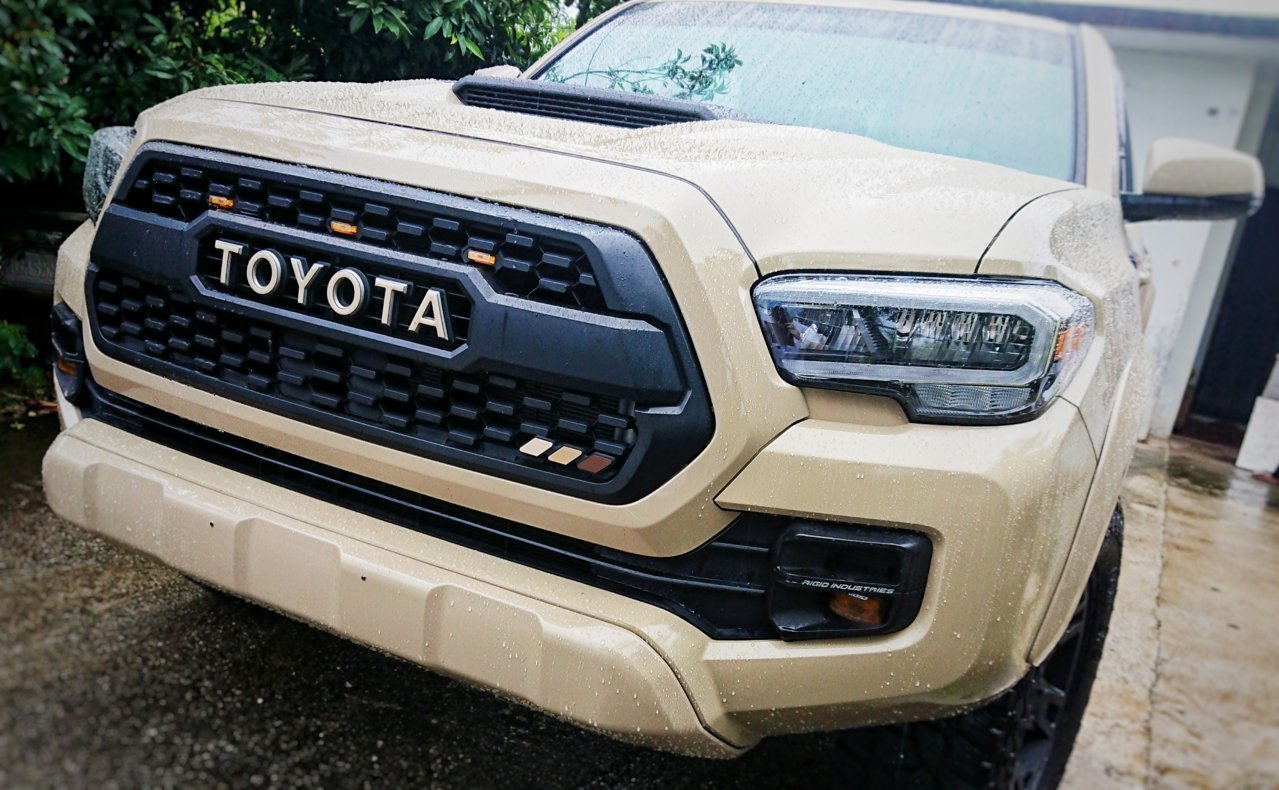

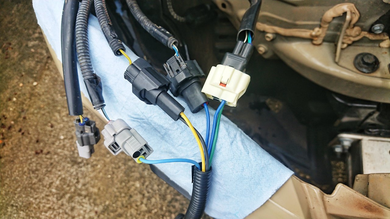

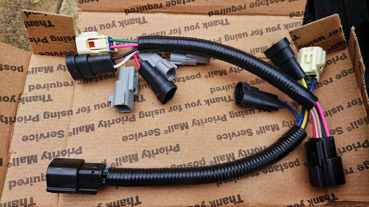

  11. Sep 14, 2020 at 8:37 AM
    #291
    Rainoffire
    Rainoffire Well-Known Member
    May 31, 2018
    #255034
    3,108
    2017 QS DCLB TRD Sport
    What was the issue? I hear the same thing happen with the TRS harness from time to time.
    Also love @xrunnerdude67 harness, being color coded, it is really hard to mess up the install.
    Makes it simple and easy.
    Need to figure out how to hide all these wires though.

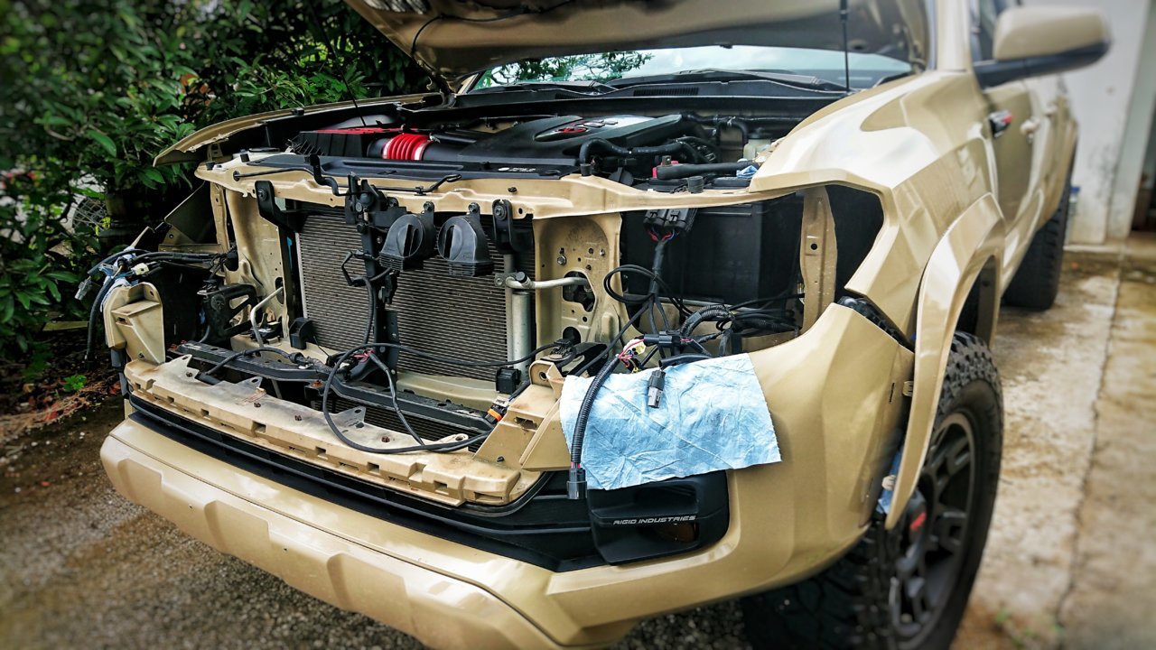

    Kind of cramp behind the headlamps.DSC_3637-01.jpg DSC_3643-01.jpg DSC_3642-01.jpg DSC_3639-01.jpg DSC_3645-01.jpg DSC_3665-01.jpg
    Used a lot of shoptowels, was afraid to scratch anything. And the fenders had a lot of mud...
    *Yes, I need to powerwash the driveway...
