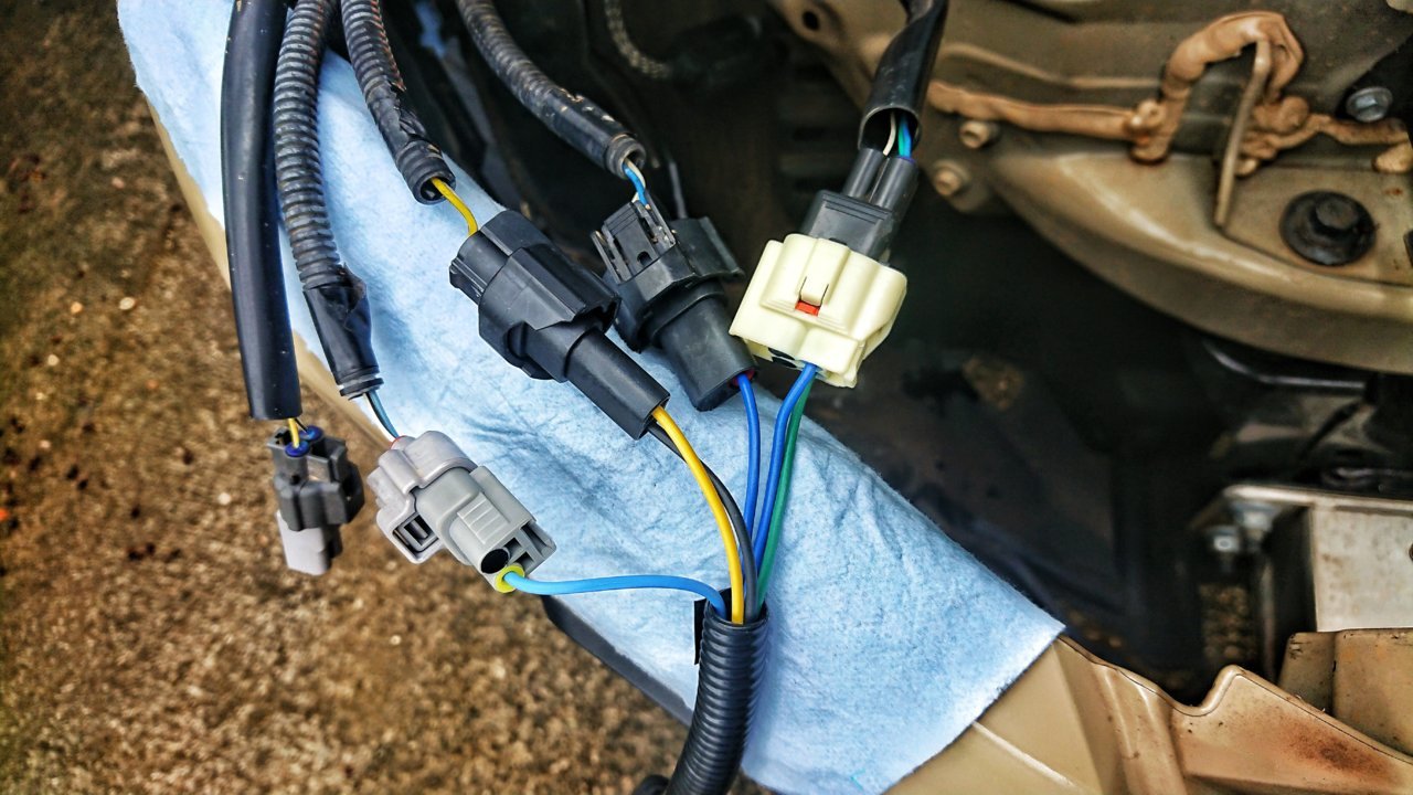

    Yea I got Mikes harness and it works perfectly. All you need to know is that the low beam connector is the plug that only has 1 wire, the high beam has 2. Nothing else can really be hooked up wrong.

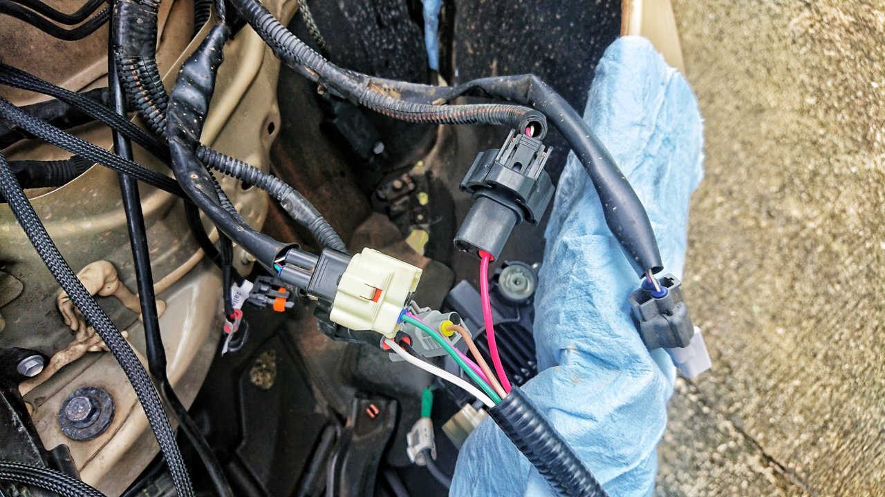

    and you do t even have to make it that complicated. Wire colors match up perfect

    The confusing thing is that you have connectors with two wires (OEM harness) and mikes only has one wire in connectors that can take two wires but only have one. So if you match everything up by deductive reasoning its fairly foolproof.

    Honestly the dealership installed the headlights and harness when I got my truck and didn’t charge me for labour, so I’m just assuming it was easy. Haha. The lights perform great though.

    It is red, pink, tan, Lgreen, black and white for the driver's side. The conversion harness wire colors match up with the original harness wires.
    It is Lblue, blue, blue, green, black and yellow for the passenger side. Easier to see the matching colors.

    Caribbean, Puerto Rico
    05 PreRunner TRD Offroad AutoTrans
    Hood Struts, My version Fogs always ON, Map & Overhead Light Mod,
    Shows the rats nest...:rimshot:

    The only one I couldn’t get actually matched was the ground, which mine is black and the factory is white/black tracer. But I figured black is a “universal” color for ground. Lol
