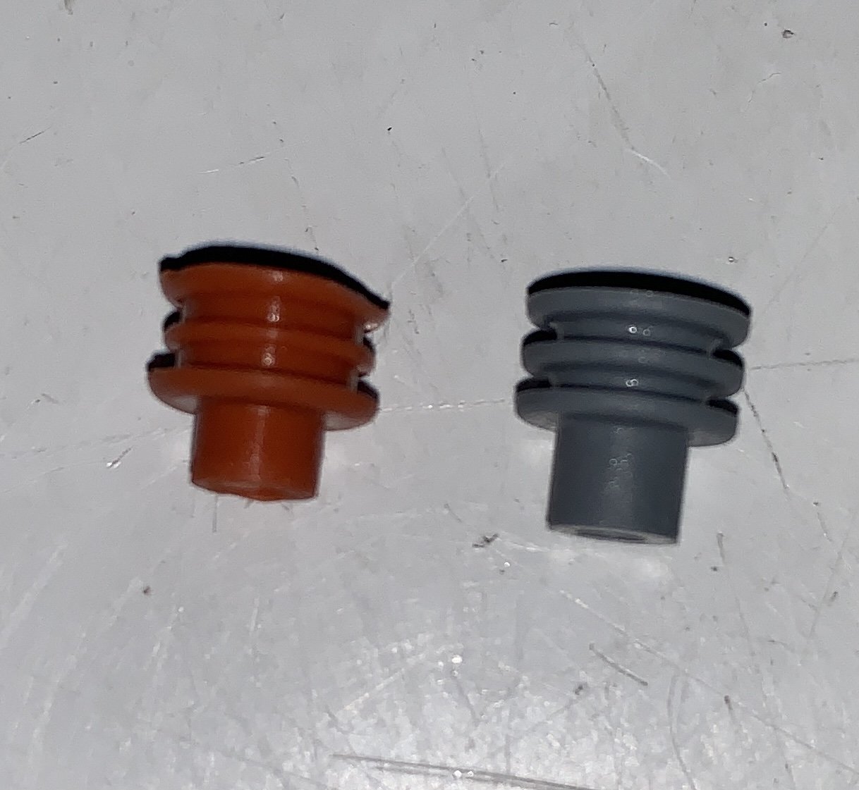

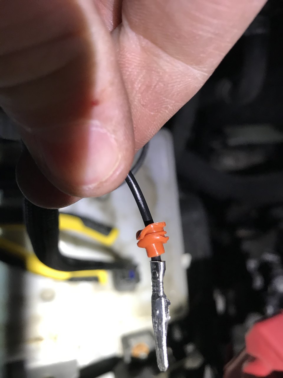

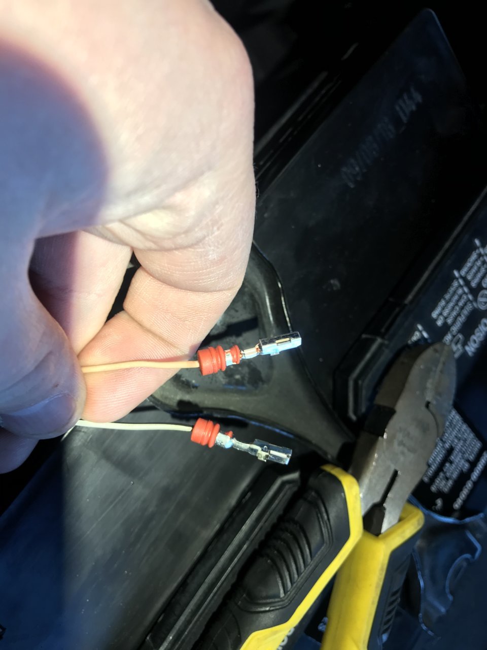

    You can de-pin the connectors so they don’t have to be cobbed together, it’s really easy, just use something pointy like a pick tool. The gaskets are very poor quality, I’d probably still go with Mikes. TRS offered me a refund when I left a bad review about the harness.

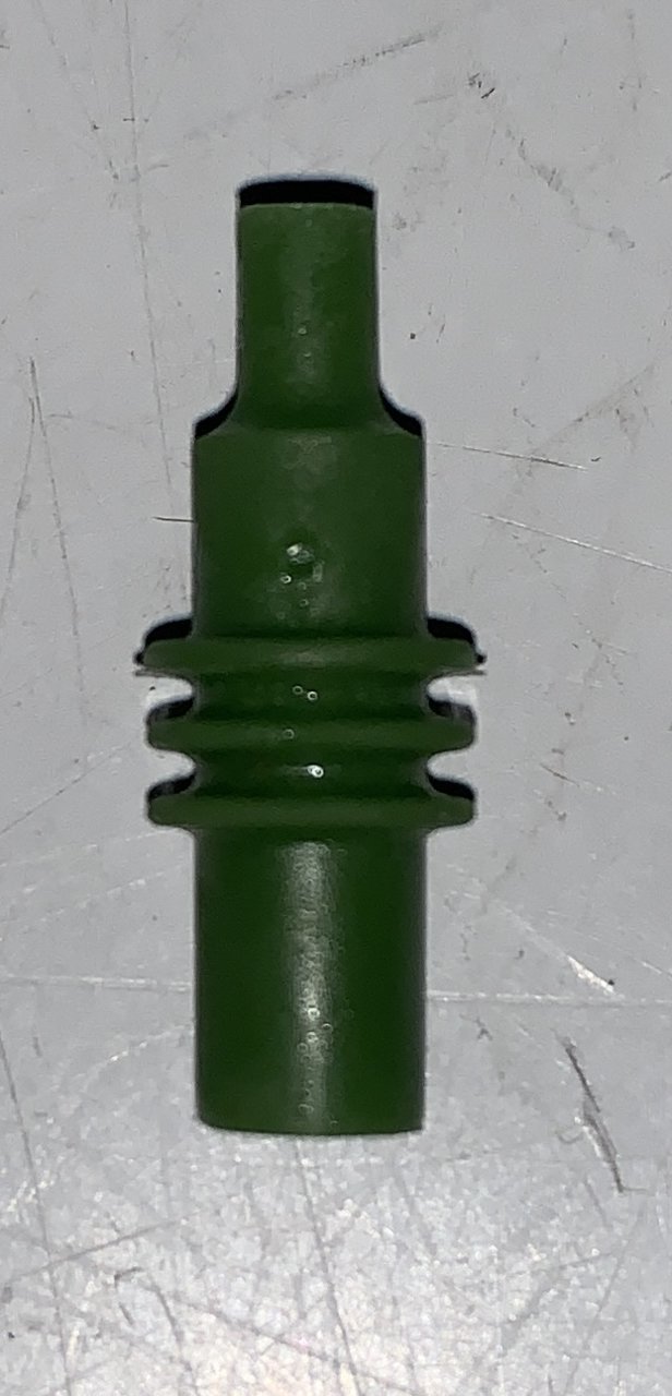

    In all fairness, the Morimoto looks like it wasn't properly crimped (not that that is any better, but those gaskets do slip out easy). The actual gasket itself is most likely the same one that Mike is using. They aren't the best gaskets to begin with, that is for sure. But the OEM is a Sumitomo gasket, and those are much more robust. The best thing to do for the H9/H11 is to use a Delphi Weatherpack/Metripack280 gasket. They are better all around. They are thicker and the crimp area is longer, not to mention they come in different sizes so you can get a better seal if you are using smaller wire. Also, you can use a Delphi plug to fill that hole on the low beam connection. This is useful info if you are DIY'ing it, but nothing I would worry over (except maybe the plug if those aren't already being used).
    Here are the standard H9/H11 gaskets vs Delphi
    And here is a Delphi plug, just FYI
