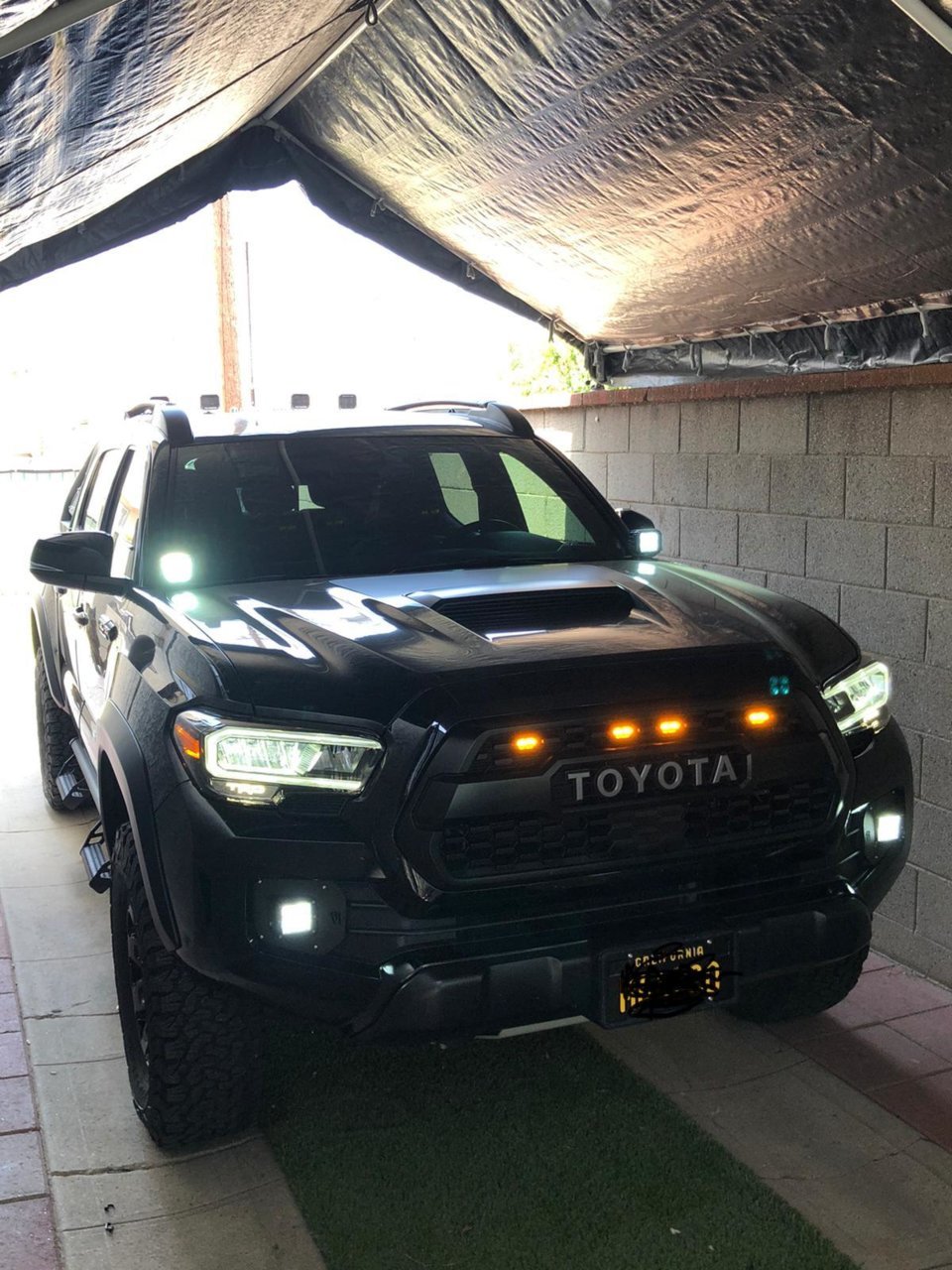

    Goncalves_Taco
    Goncalves_Taco Well-Known Member
    Nov 3, 2019
    #309766
    279
    2017 Black Tacoma TRD Sport
    tac0will and Tacospike like this.
