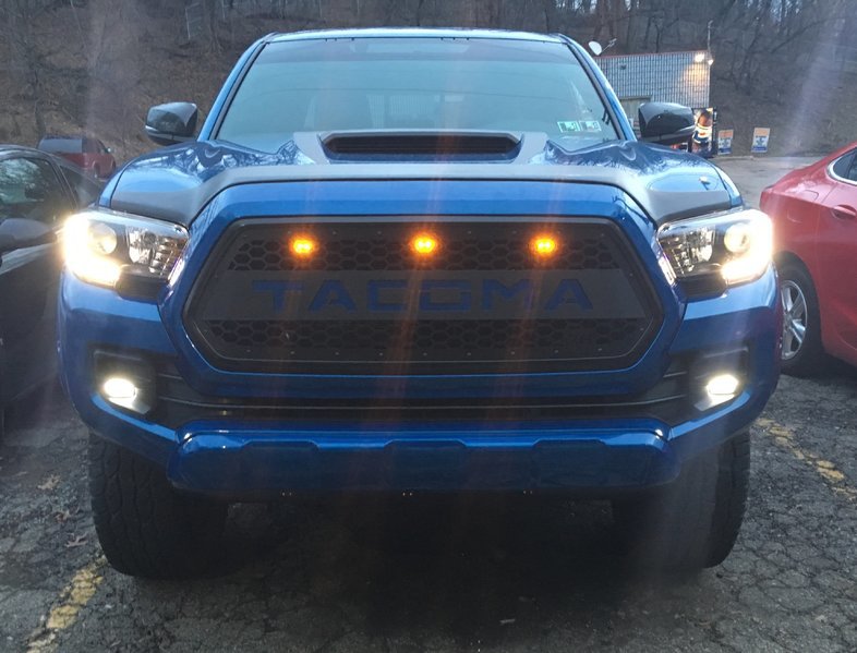

    Wired up lights

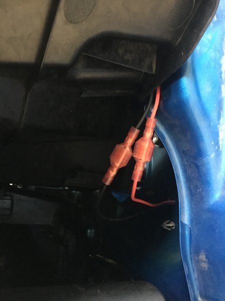

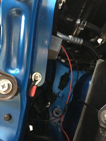

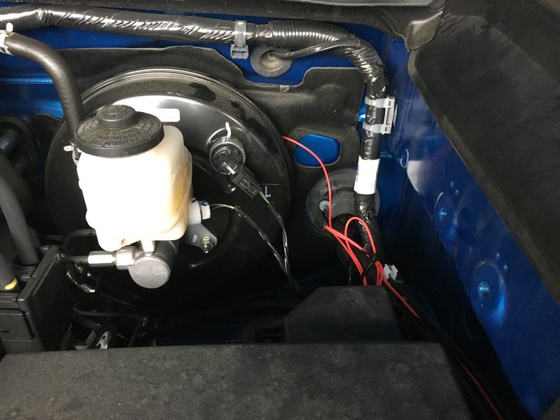

    I have reinistalled I'll post some pics of installation
    Added some waterproof connectors in the front to be able to remove grill if needed without having to unwire lights ( not included in kit)
    Ran ground and attached
    Ran power wire through firewall hole located behind master cylinder (must remove rubber plug first)
    Attached to fuse box located under drivers side dash ( be sure to remove 15 amp fuse and add 15 amp fuse that came with kit below the 3 amp fuse if not already installed) IMG_2595.jpg
    Lights will turn on as soon as truck is powered up
    I do recommend picking up the plugs to attach in the front incase grill is ever needed to be removed. Hope this helps out with installation for everyone.

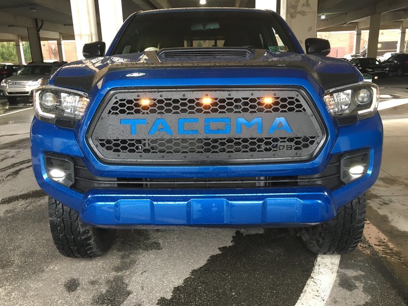

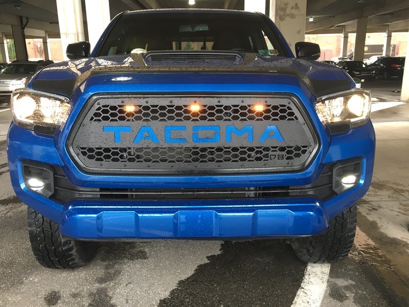

    What grill is that?

  18. Mar 15, 2017 at 6:21 PM
