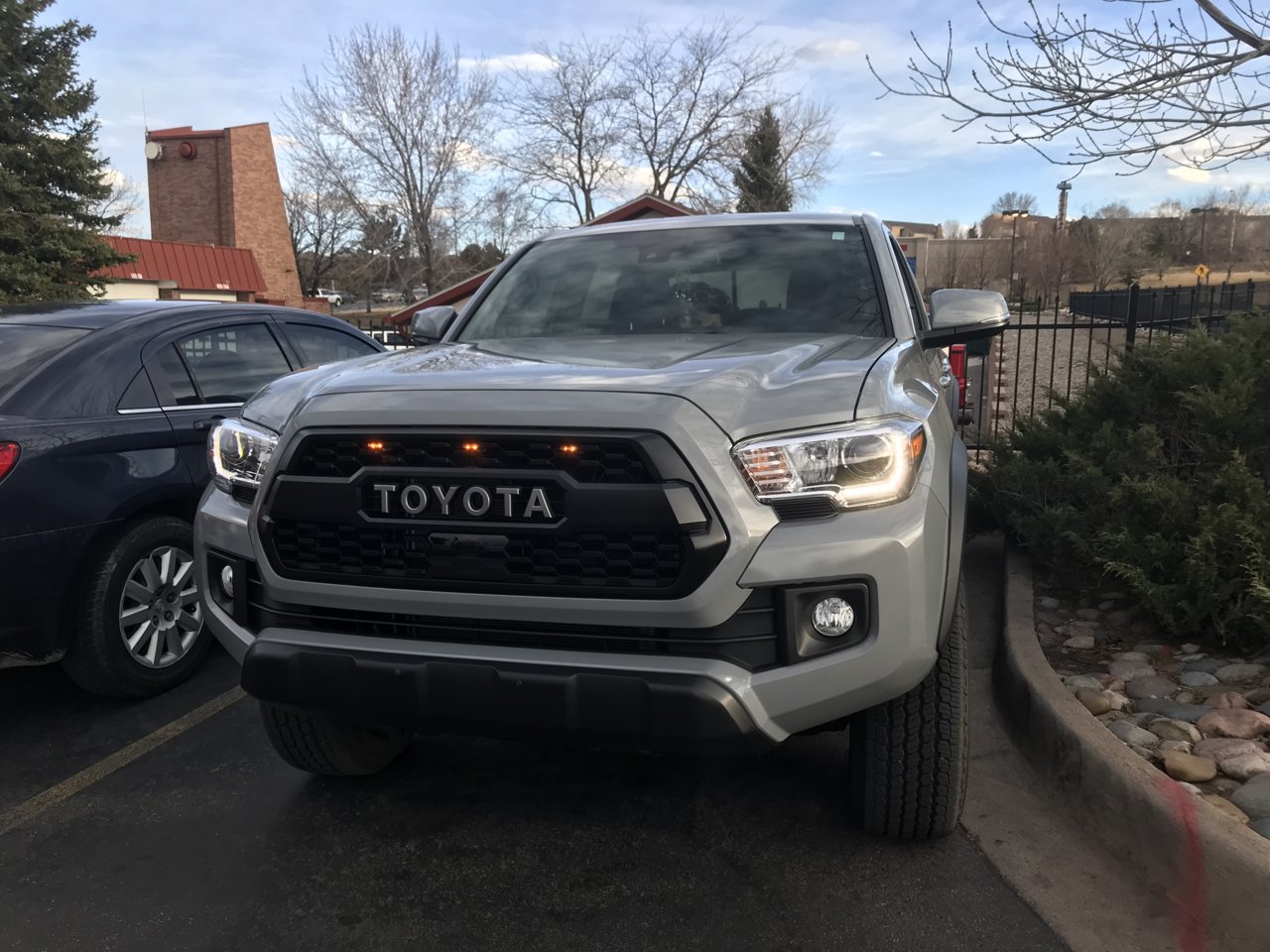

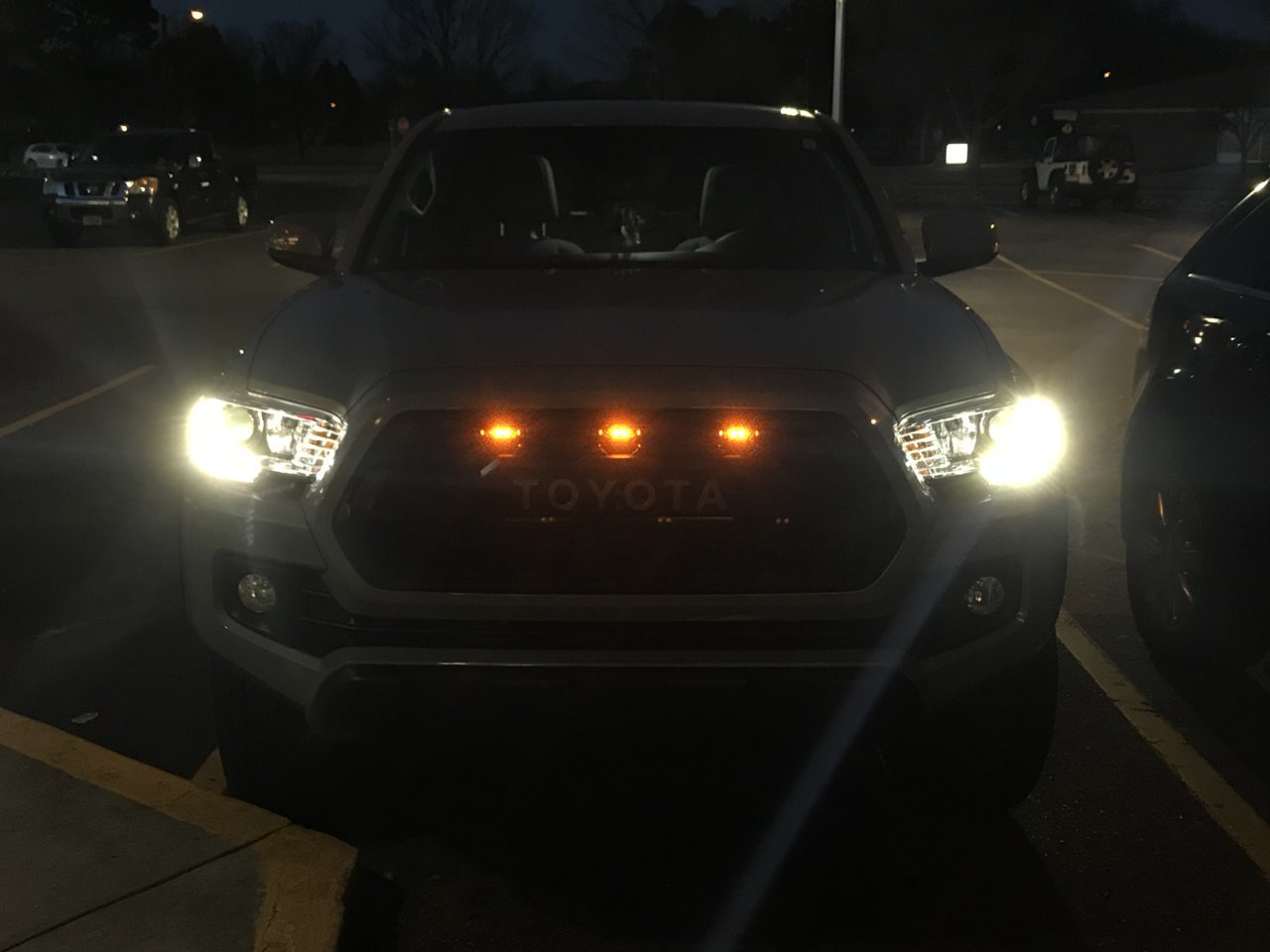

    If these are the tacomapro, then yes just installed a couple of days ago.

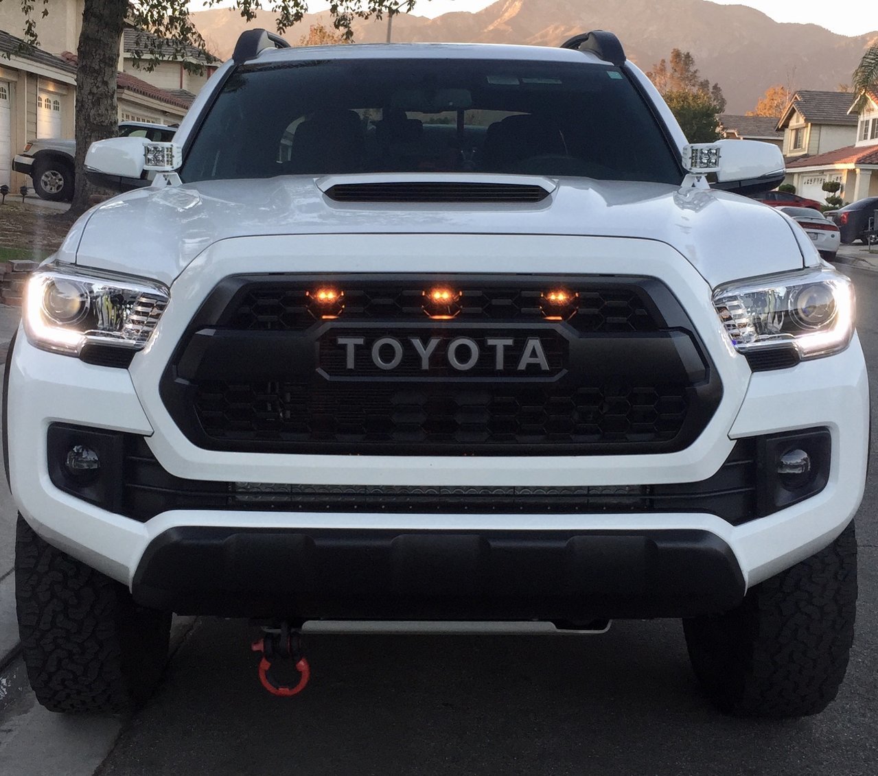

    Works pretty good with the pro grill

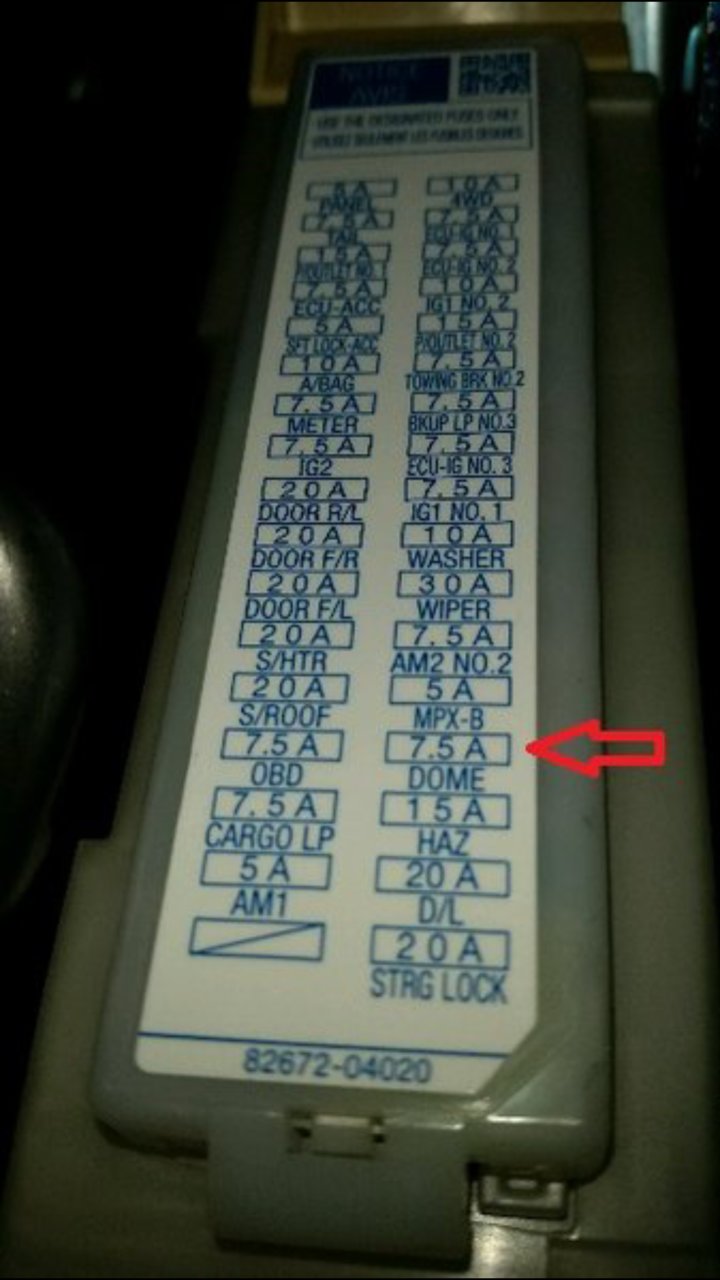

    Just finished installing the TacomaPros raptor lights. Pretty easy. Only question I have is where people are tapping into? I just used the fuse tap and ran it into the interior of the truck, but want the raptor lights to turn on when I turn on my DRLs. Any suggestions on how to make this happen?

    Move the fuse tap to the top left fuse... ignore the arrow
    The one labeled “tail”

    That works good enough for me. Thanks!
