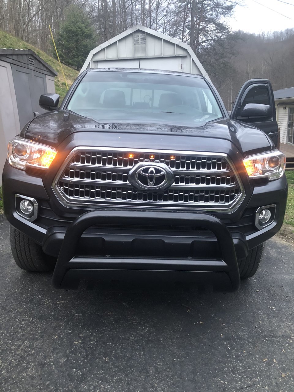

    It’s likely not a kit, i wired up some lights I bought from superbrightleds.com and built a mount for them using a small price of aluminum angle from Lowe’s. Wasn’t too hard and saved me $40 bucks and yku could use whatever color lights you want9E27A15B-942F-43A6-81FA-224CC1E29D17.jpg

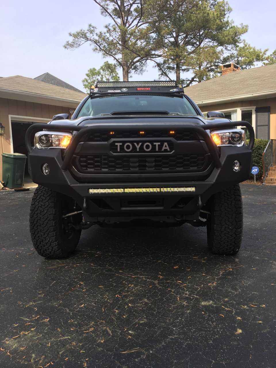

    Just got mine on. Install was kind of a pain in the ass. Its a pain getting the grille off anyway with this bumper and I broke two clips trying to separate all the layers. They may have been weak from the first time I took them off to put in the Pro insert. Anway, lots of questions about wiring..
    I wanted the raptor lights to be on all the time with my DRL's which I have on all the time. sooo, I grounded out the raptor lights on a screw in my engine bay, right next to the negative battery terminal. I ran the fuse tap into the engine bay. I currently have the first and second (top) fuses on the left taped for my roof and bumper light bars, so I tapped the armrest cigarette lighter. So the raptor lights turn on and off with the car. I would have liked to have them turn on and off with the DRLs but didn't see a fuse tap for DRL's. Anyway, I think it looks cool, even though they are mostly obscured by the bumper.

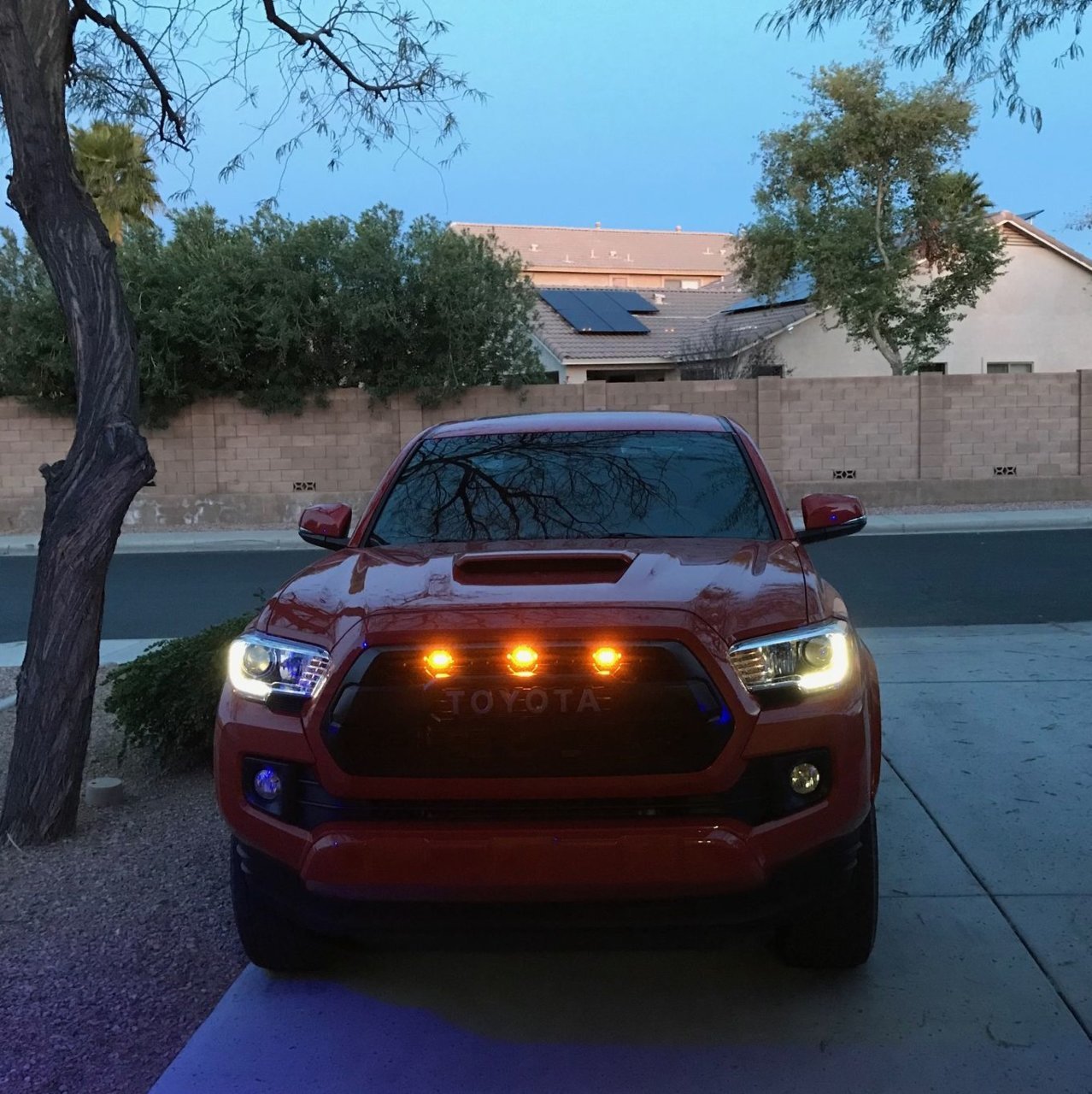

    About 6 bucks and a hour of my time. Wired into the park lights right off the plug. Color matches perfect
