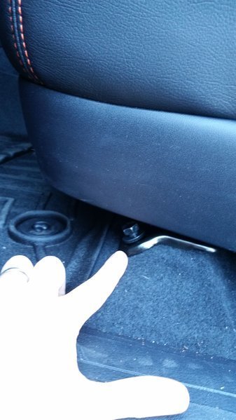

    Found my rocking chair fix, simple enough to find. 9/16th check both front bolts.

    Those bolts look like they tighten the bottom only it's the back of the chair that's rocking.

    If the fronts aren't tight when you brake and accelerate he seat is going to move a little. This isn't going to help your situation as they removed his seats to install the leather. Yours should be tight from the factory

    Did you tighten them? Hopefully they didn't cross thread them

    Tighten them them. Fixed issue, no more rocking.
