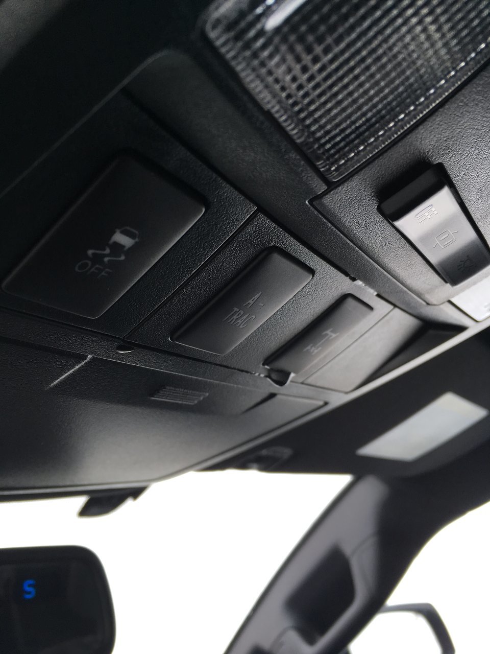

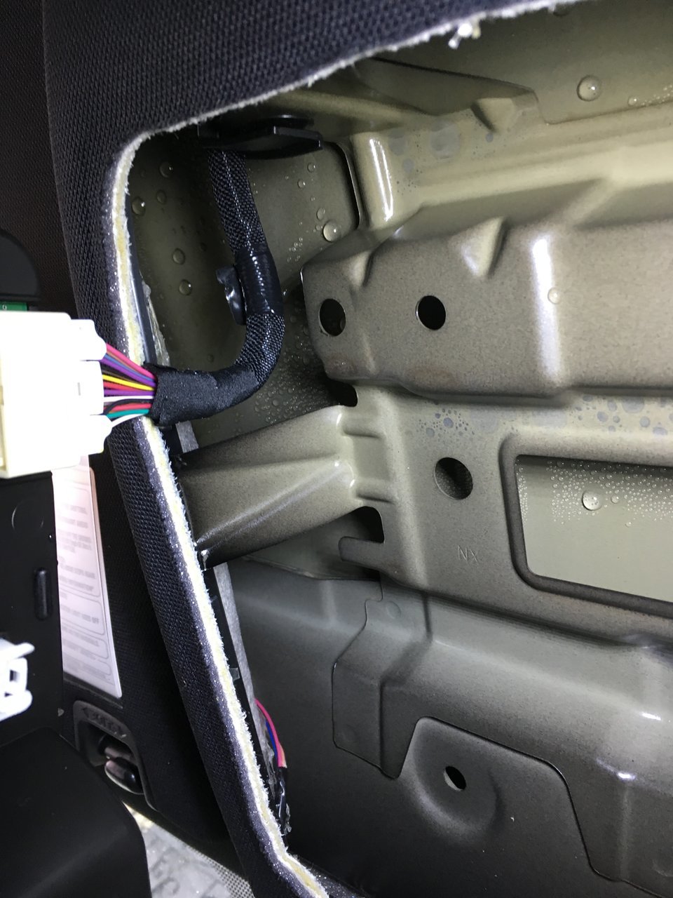

    IMG_1355[1].jpg IMG_1358[1].jpg i have water leaking from the overhead buttons, like where the diff lock button is... water doesnt seem to be dripping down anywhere else in the truck?? could this also be caused by the 3rd brake light? have any of you guys seen a leak in this spot too?? everybody is talking about double cabs here but mine is a simple cab!.. i will take it in to dealer this week for sure but i just want to check on here if anybody else as encountered a leak in that location?! help!
    heres a little update.. looks like condensation!? has anybody seen this before?

    This is an issue in colder climates. Condensation builds up on the cold roof then melts and drips down. Some things that help are to make sure you don't use the recic button, don't get into an extremely cold cab, wait until it warms up, don't park it inside a warm garage, crack a window or turn on the AC to help get the moisture out if you see condensation on the inside windows forming.

    As soon as it warmed up all the condensation that was stuck on the roof melted off causing the inside leakage. The challenge is to keep the condensation on the inside to a minimum which can be challenging when it's -40c. Let your dealer know. There was a tsb on the Gen 2 for the same problem but nothing for the Gen 3 as of yet.

    i doubt its coming from the windshield in my case.. from what im seeing its clearly condensation on the steel of the roof itself. i will go and show these pictures to my local dealer for sure tho!! thanks for that info ! also.. i dont have a sunroof ;)

    1)he doesn't have the problematic 3rd brake light(only found on the double cabs) he has an access cab
    2) even if it wastes light, the headliner is slightly arched. So unless he was parked facing downhill the water wouldn't drip from the brake light up and over the dome light into the overhead switch panel.
    I'm betting it's the condensation theory

    thanks for that! im also betting on that assumption. if im correct, the picture shows very small water droplets that indicate condensation? and not a water infiltration.

    update, i have shown the pictures to my dealer and apparently there is some sort of insulation that they can add that would "fix" this but its back ordered.. now im plyaing the waiting game..
