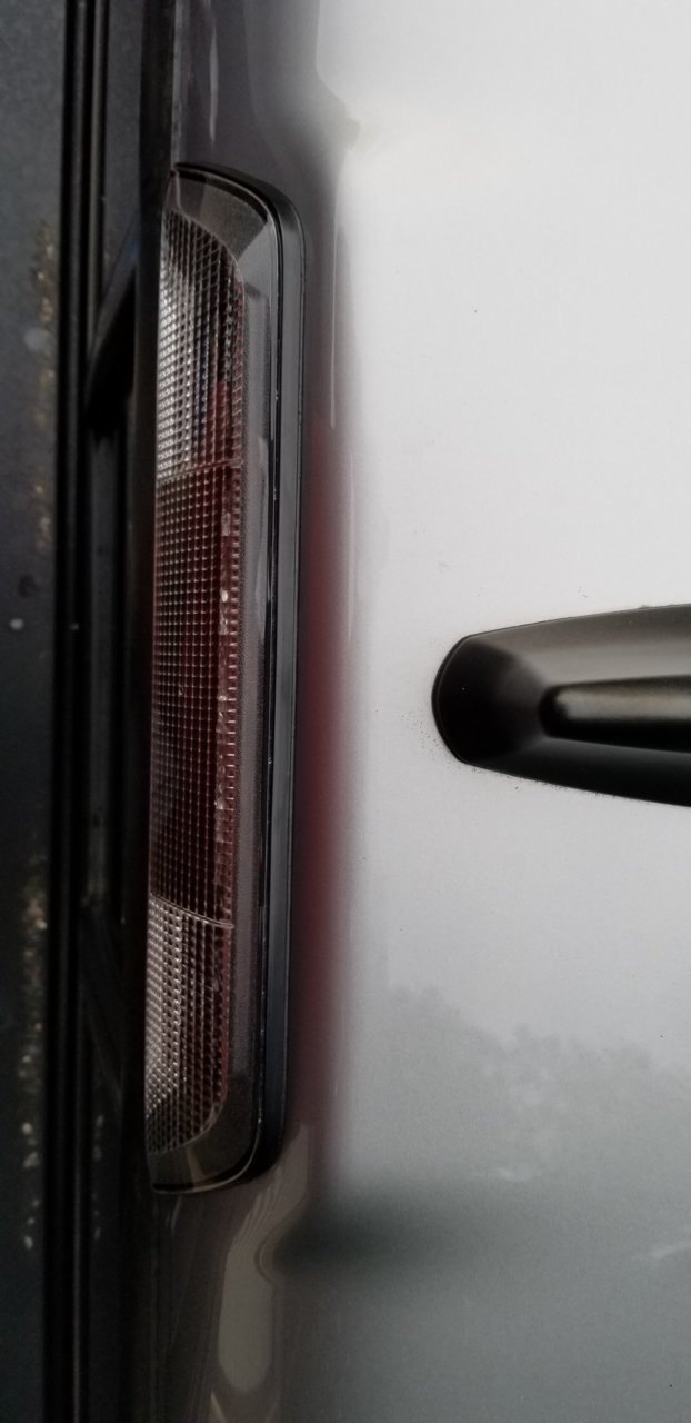

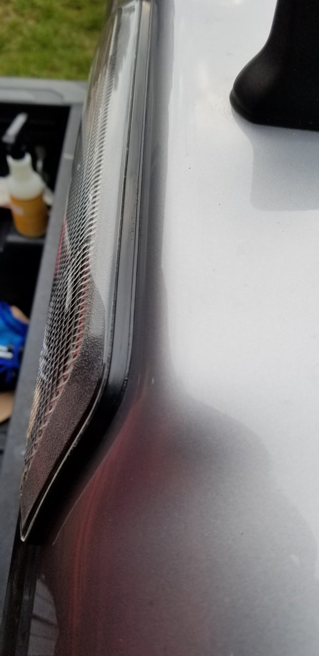

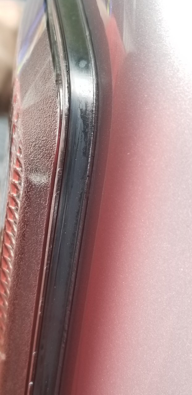

    I caulked mine in almost a month ago. We have had plenty of heavy rain and even some hail but my truck is water tight! All it cost me was $7 for the tube of black silicone and 15 minutes. If you zoom in you will see the thin line of caulk that is invisible unless you get really close to it.

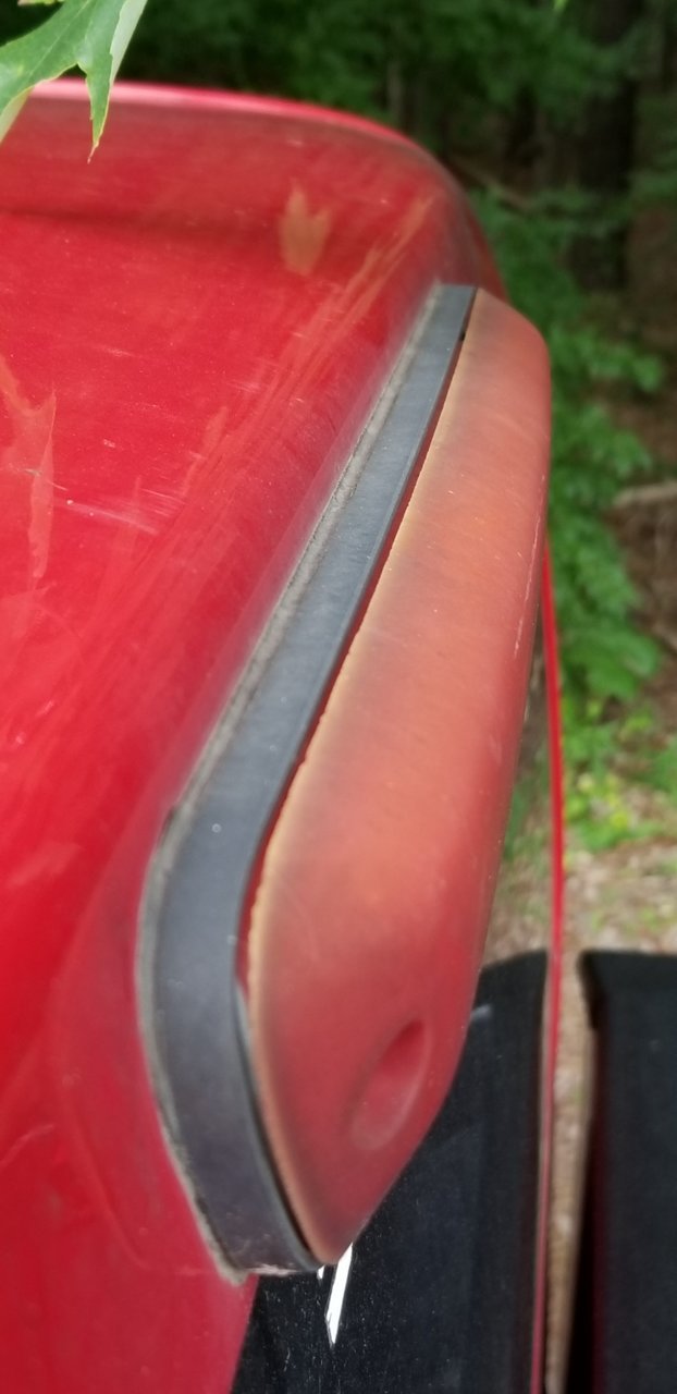

    I also attached a picture of my Colorado that's been caulked for years and still no issues.
    I hope this helps anyone that doesn't want to spend $600 to get "fixed" by the stealership.
