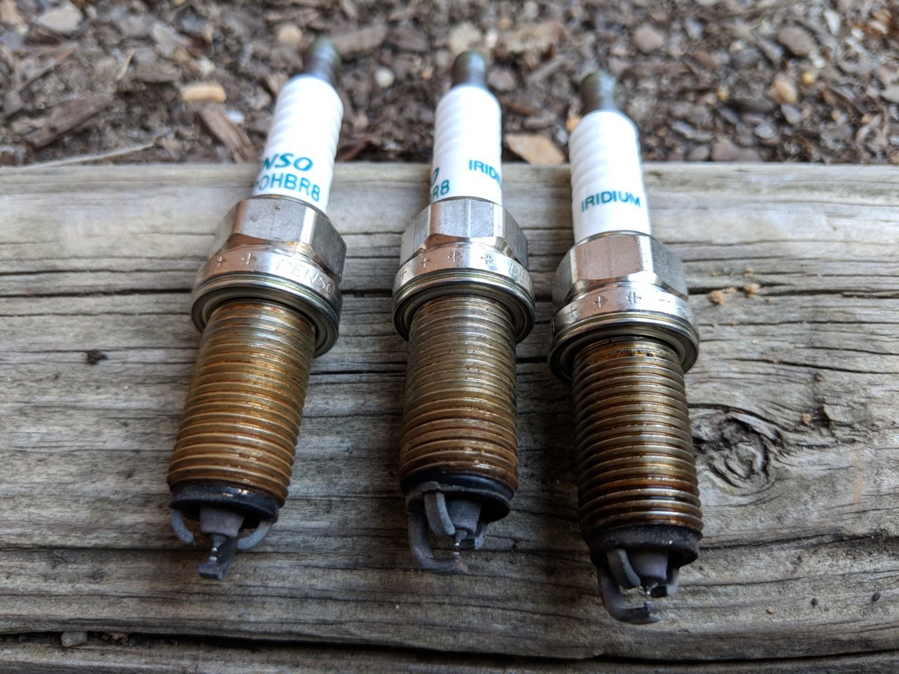

    Thank you so much for this. Adding some additional info to this thread for reference, below are the part numbers out of the manual
    Spark plugs :
    - 2TR-FE engine (4-cylinder in line, 4-cycle)
    DENSO FK20HR-A8
    - 2GR-FKS engine (6-cylinder V type, 4-cycle)
    DENSO FK20HBR8
    Gap: 0.031 in. (0.8 mm)
    NOTICE:
    - Iridium-tipped spark plugs
    Use only iridium-tipped spark plugs. Do not adjust the spark plug gap.
    Reference owners manual:
    https://www.toyota.com/t3Portal/document/om-s/OM04005U/pdf/OM04005U.pdf

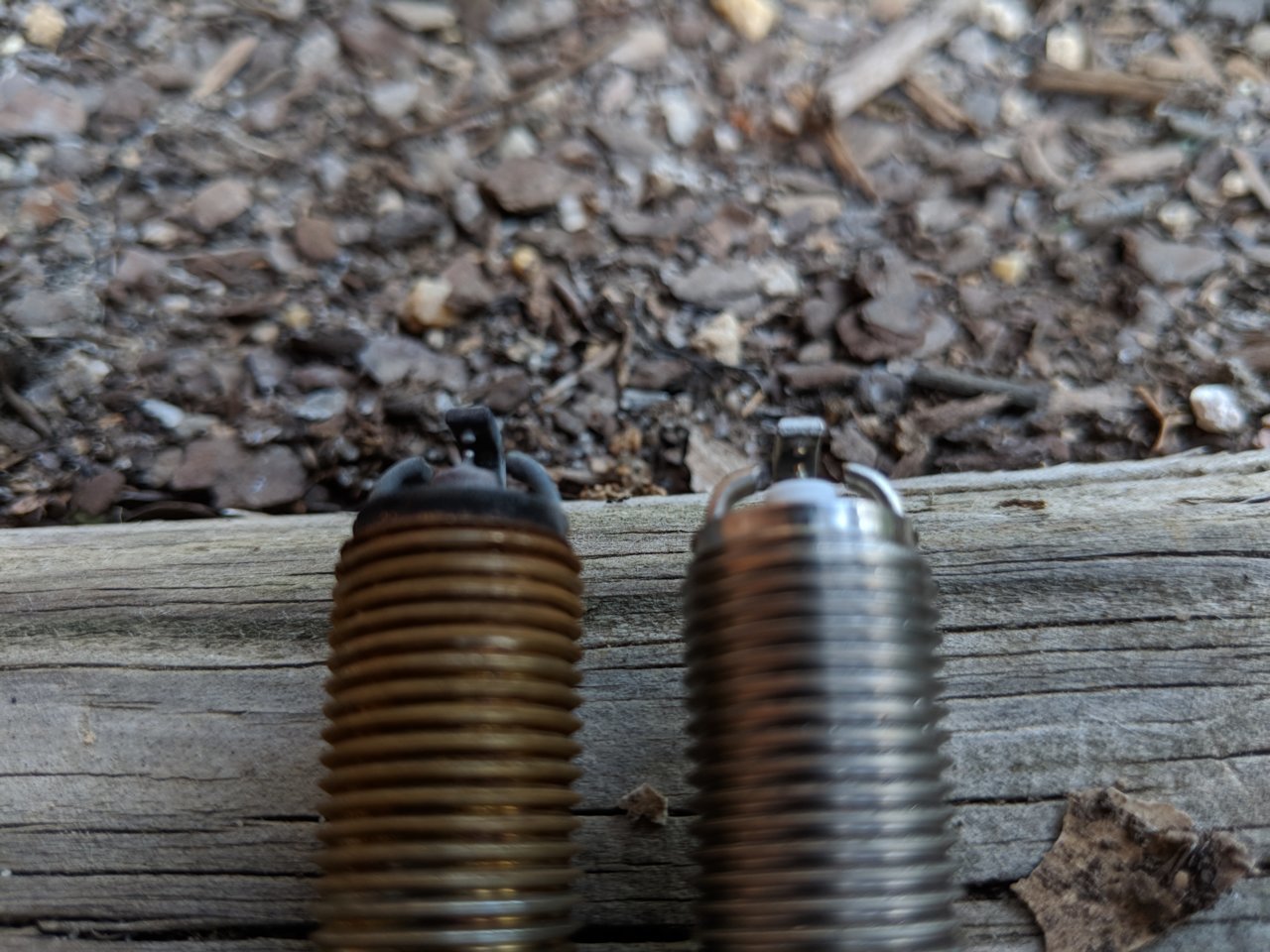

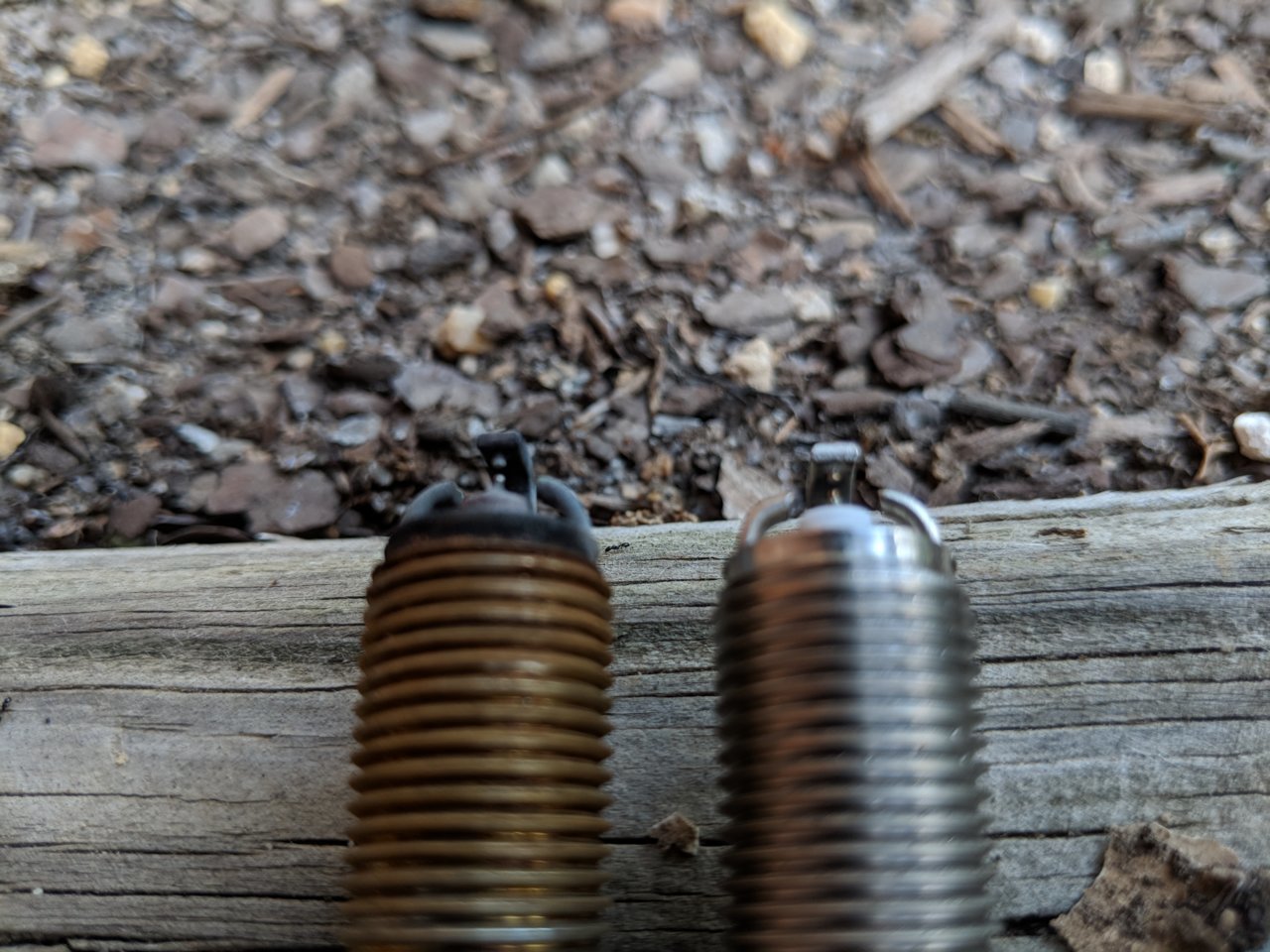

  12. Sep 14, 2018 at 3:06 PM
    #32
    Ronzio
    Ronzio Well-Known Member
    Feb 20, 2018
    #245114
    2,401
    Pennsylvania
    17 DCSB TRDOR
    You want the open part of the electrode on the spark plug pointed towards the intake valve...I usually buy a couple extra plugs and have to thread more than one plug in the same cylinder to get it in the right position or you can cheat and buy indexing washers that slide over the plug...

  13. Sep 14, 2018 at 3:42 PM
    #33
    SpeySquatch
    SpeySquatch Function over Form
    Mar 6, 2018
    #246516
    5,968
    2016 TRD OR DCSB
    C4Fab LoPro, BAMF Sliders, Adj. Ext ADS, 4.88's, OVTune
    How do you know where the intake valve is?

  15. Sep 14, 2018 at 8:32 PM
    #35
    SpeySquatch
    Mar 6, 2018
    #246516
    5,968
    2016 TRD OR DCSB
    I just don’t get how you know the plug is pointing towards that. Do you count rotations by marking the plug?
  16. Sep 15, 2018 at 8:39 AM
    #36
    Ronzio
    Feb 20, 2018
    #245114
    2,401
    Pennsylvania
    17 DCSB TRDOR
    You put a registration mark on the 3/8 extension drive you’ll be using to install the plug in the cylinder head that way you know where the open part of the electrode is

  19. Sep 21, 2018 at 7:50 PM
    #39
    SpeySquatch
    Mar 6, 2018
    #246516
    5,968
    2016 TRD OR DCSB
    I just replaced the wrong ones I put in with the correct ones. Went for a drive and there is definitely a slight change. Seems more responsive to throttle and the idle sounds calmer
