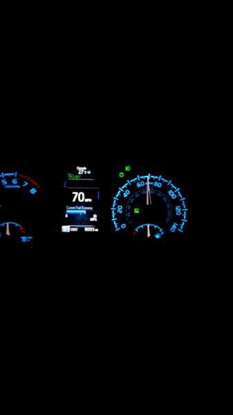

    My analog gauge is about 2 - 3 mph slow compared to the digital at 70 mph.
    Edit: The digital readout is the correct speed.
  12. Jan 17, 2016 at 2:19 PM
    #52
    swimmer
    swimmer Well-Known Member
    Apr 21, 2015
    #153626
    2,527
    Tucson
    2016 TRDORAC4WD
    Same
    Same here. The digital readout is correct.

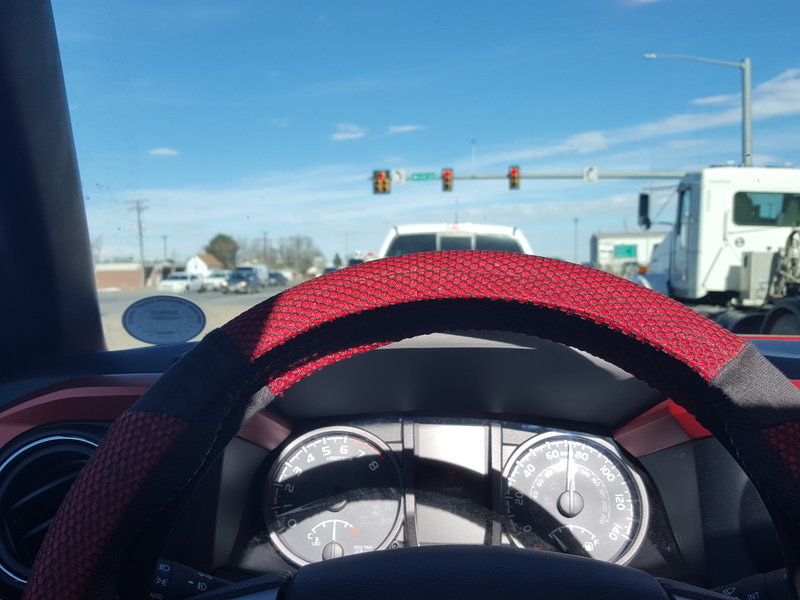

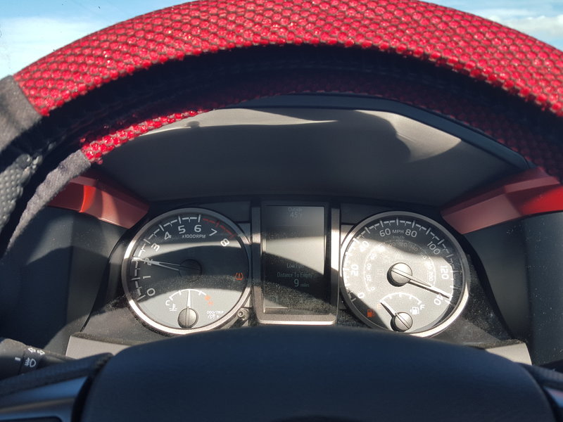

    Hey, i am from colorado also and i just had this happen to me today.... I was driving back from Lonetree and the speedo was ticking... then all of a sudden, i was stopped at a stop light and it said i was going 70MPH... when i accelerated, it went up to 140mph.... the only thing that reset it was when i shut the truck off and the needle finally went back down to 0. I took it to Ehrlich Toyota of Greeley and they told me that this is the first time Toyota has heard of the problem... which i guess is not true, judging by these posts. I will be sure to show them this video. Before i saw this post, i told the dealership that i think that it was the cluster that is messed up. They took 3 hrs trying to diagnose what the deal was and finally gave me the 2 options... of course, i took my truck. Shipwreck, shoot me a message and we should exchange numbers, i want to see if the new cluster really helps you, and i can also refer my dealer to yours!
