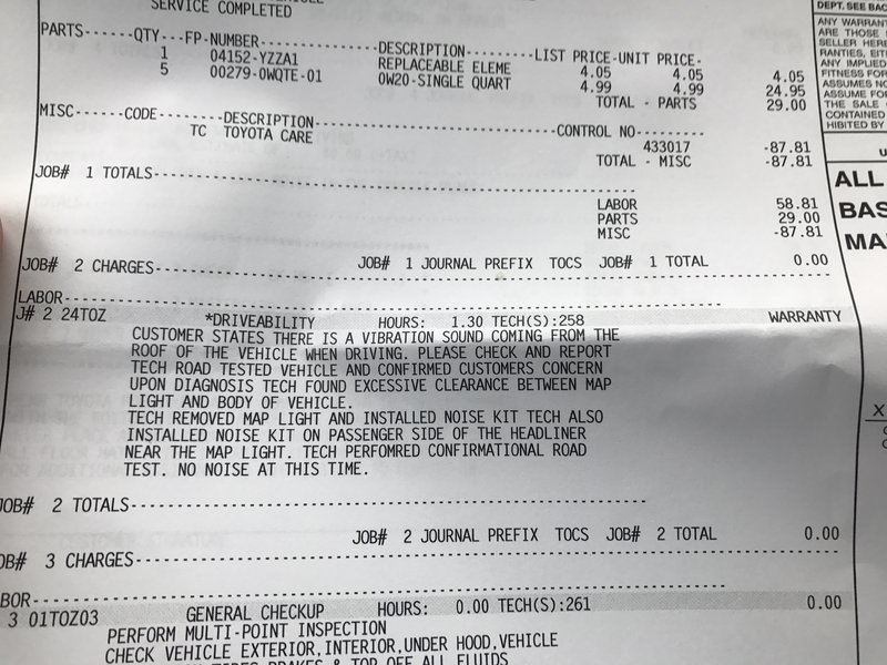

    Hey.I was very busy after I picked up my taco from dealer...So the noise is gone...not sure exactly what they did...
