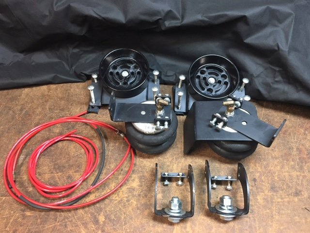

    Hi all. I have a 2016 TRD Sport that I tow my boat a lot with during the summer. The stock suspension was hitting the bump stops frequently so I decided to get the softer set of sumo springs for the rear end.
    They said they wouldn't effect the everyday driveability of the truck but that's just not true. Every time the rear end hits a bump it's like there's a solid bar for the leaf springs and no shock whatsoever. I'm taking them out as soon as I have an alternative.
    Does the firestone 2407 kit effect the rear suspension the same way when the pressure is low? I like the stock feel of the truck when I'm driving to work every day, but need a little extra spring when I tow my boat.

    I bought these. They are the 610 series that their site recommended for the 2016+ truck.
    That's what I'm thinking right now too, I just don't want to instantly regret putting them in like I did with the sumos

    I had bags installed on my 2011, with the daystar cradles and the only time i noticed them was going over speedbumps, they would "clap" the cradles. If you mount them like firestone suggests (connected at top and bottom) they will not clap. When i choose to re-install on my 2017 i will likely add some rubber so they don't clap over bumps because i like the safety factor of the cradles.

    Thanks for the input! Yeah, my truck rarely sees off road use and I daily drive it on the highway 5 days a week so I need a comfy ride, but the air bags should feel like nothing when they are aired down and should work very well for the trailer when aired up!
    Now to figure out if I want to get an onboard compressor or not...

    Just realize that to install the air bags you have to cut the factory bump stops off. The bags do not have bumpstops inside them. Also you loose about an inch or more of up travel. Your rear end will still bottom out on the bags with low air pressure. I have never found a comfortable air pressure. Good luck.
