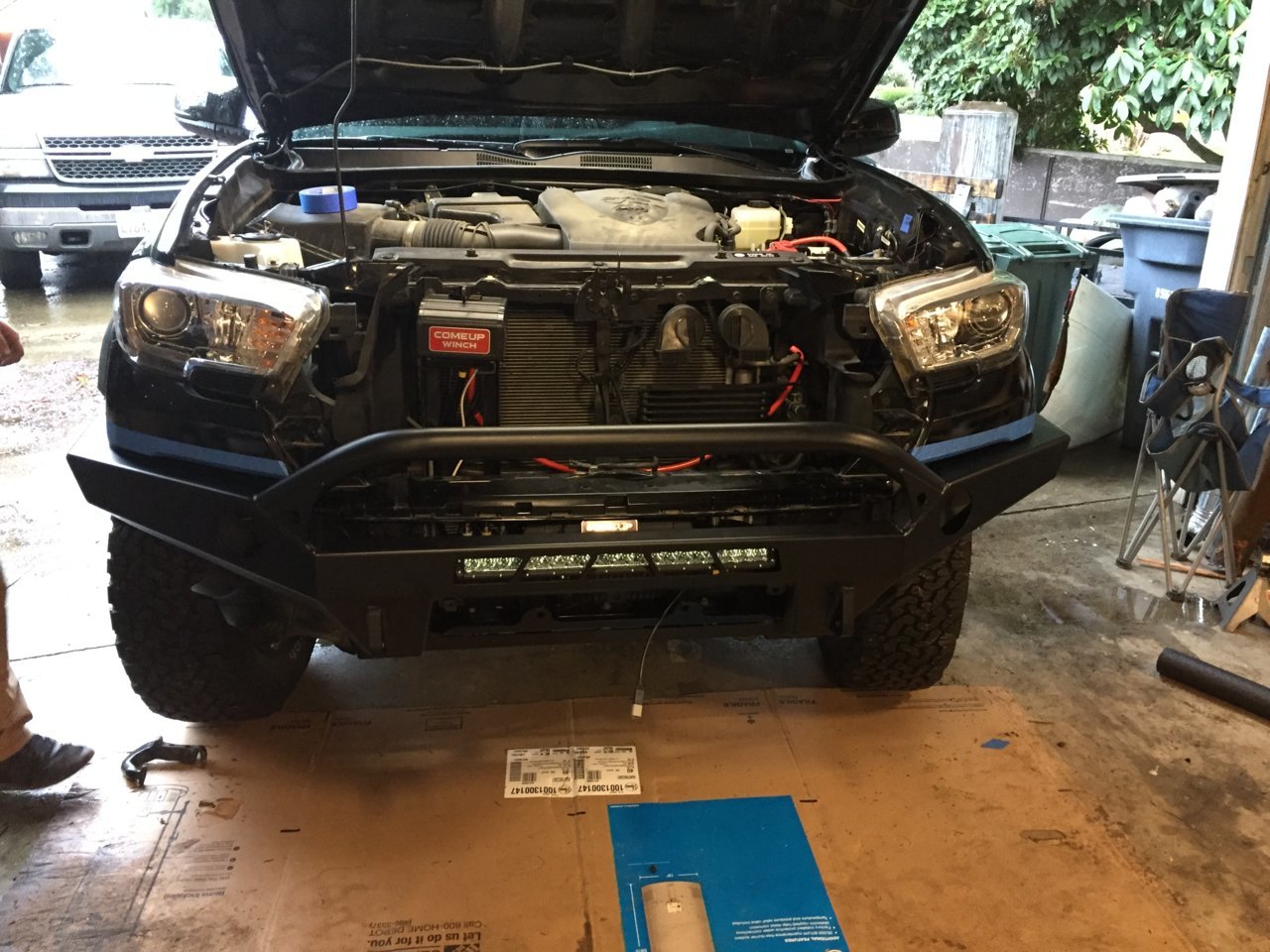

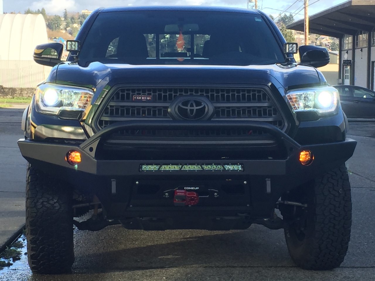

    Didn't realize CBI had a T3 thread. Installed mine a few months back. Super happy with the bumper! Install took a day with help. Managed to get a small bracket fabbed up to mount the control box for the winch (Comeup 9.5rs). Mounted on the passenger side and just in front of the radiator. Unfortunately mine was shipped without the side frame support brackets - only took a few days to get the replacements, and the bumper seemed fine without the side brackets until they showed up.

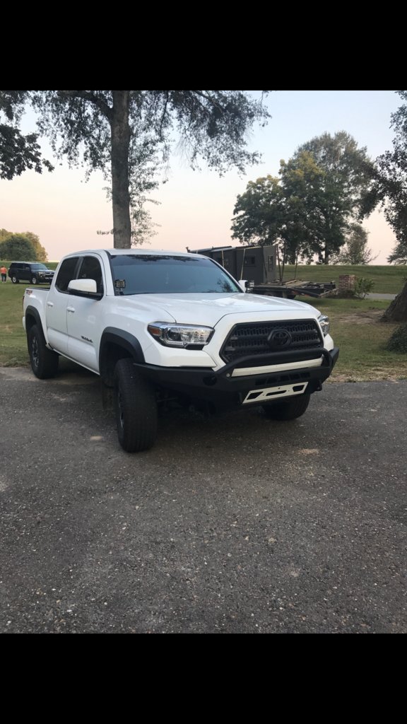

    I also have the same fender flares. I ordered the bumper already. Any pics with the 2" change? Trying to figure out if I also need to call them on this. TY!
