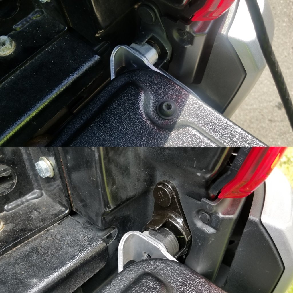

    Just had my rear tailgate bushing fail, went to dealership, and they replaced with the undated hinge under warranty....they replace only the hinge assembly....the bushing is not as wide as the original and has nothing to do with the dampener.....took about 1 1/5 hrs. for them to replace....showed dealer cost on hinge 67.00 list 112.00 and bushing 9 bucks...

    That's interesting. Not sure what you mean by "has nothing to do with the dampener"? The hinge is part of the dampener that allows for soft tailgate drop.

    The hinge goes into the dampener, it however is a separate part, when it gets replaced the "hinge pin" is just a little narrower...worst case it looked like you could remove the "hinge pin" and machine or grind it down to fit the newer bushing...

    I just put the new bushing on, Then I lowered my tailgate and I heard a CRACK. RIP new bushing :(
    I think I'm going to install a new bracket and get the new bushing. The 3D printed one will work for now, but it's already broken the same way the OEM one broke. Less than a minute on the truck too!

    You can grind down the original pin, but be advised you will need to remove the rear bumper to get access to the entire assembly....or just purchase the new pin assembly if you are out of warranty...after that if the plastic bracket breaks the cost will be under 10 bucks and can be purchased from any toyota dealer....if the 3d part is printed out of PLA, it might last longer if done in ABS...

    Any chance I could get a copy of the STL file? I have a 3D printer at work and would love trying different materials since the one I just bought broke :(

    That's unfortunate and first time I've heard of that happening. My 3D printed one has been working for over a year now. Please PM me so we can sort this out.

    Unless you have an SLS printer, this will not work. FDM prints do not hold up well in this application.
