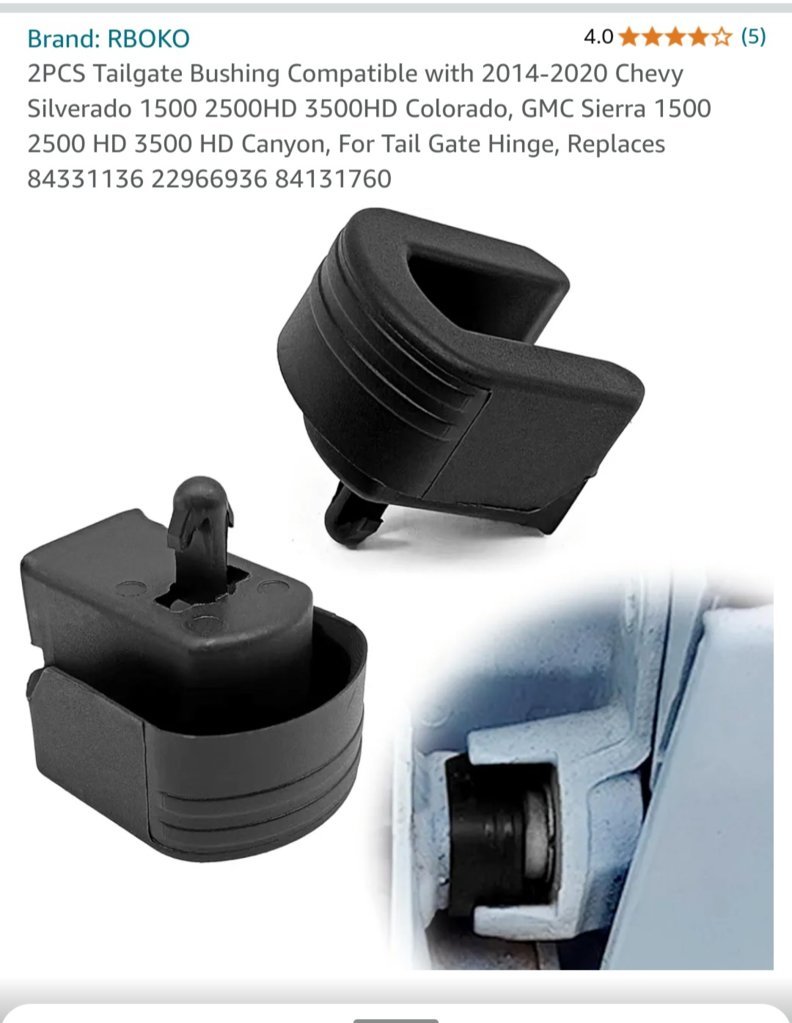

  10. Nov 14, 2024 at 5:26 AM
    #150
    Rehanks
    Rehanks New Member
    Nov 14, 2024
    #460608
    2
    This works perfectly from Amazon
  11. Nov 14, 2024 at 6:55 PM
    #151
    goshgo27
    goshgo27 Well-Known Member
    Jan 7, 2016
    #174265
    68
    Rich
    2016 Tacoma TRD Sport (double cab)
    center console organizer MBRP exhaust Automatic tailgate lock
    I’ve been using the Amazon one for a week or so and so far so good. I went through 2 NAPPA bushings in a short period and I think I paid $20-30 for each one. Even if the Amazon one fails in 2 months, it comes with 2 and is a fraction of the price. No brainer
