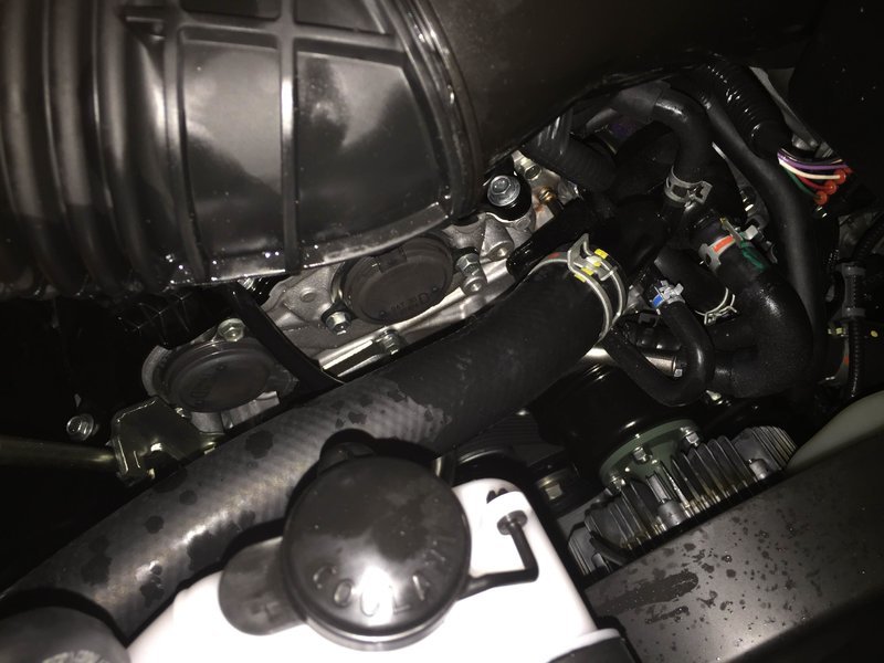

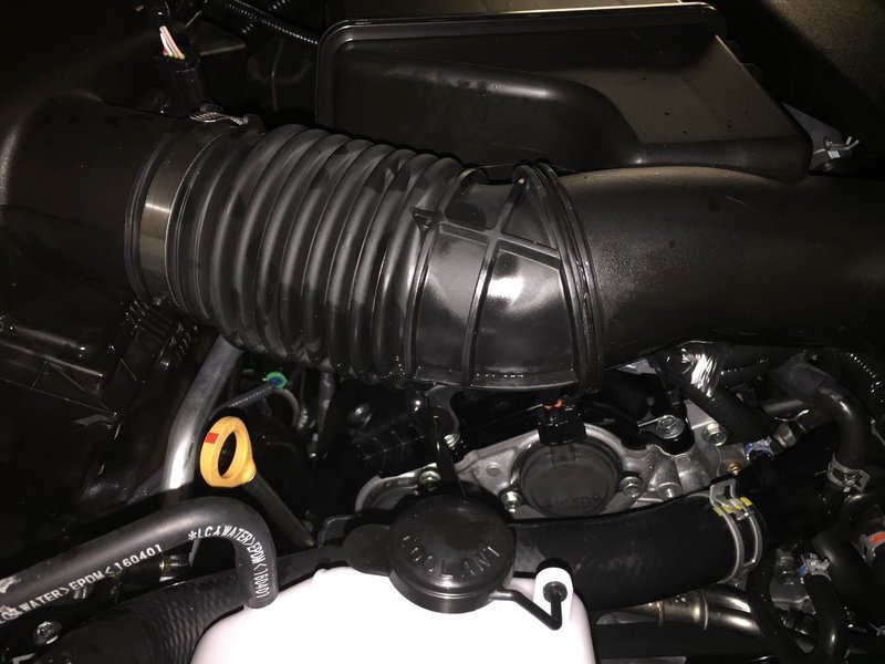

    Have had the truck for less than 2 weeks, about 800 miles on it so far. Popped the hood after I brought it home the first time because I like looking at a brand new clean engine, and just decided for whatever reason to do it again tonight. Noticed this in the pictures that I have attached. Is this what everyone else on this thread is seeing? Im pretty sure I would have noticed the greasy residue on the engine components a week ago if they were there.

    No that's not where it would be they sprayed some kind of detail stuff where your looking,look under the driver side wheel well and if it's leaking you'll see it right at the valve cover.If it's been leaking a while look under the truck it'll be all wet.Thats how i noticed mine.good luck
