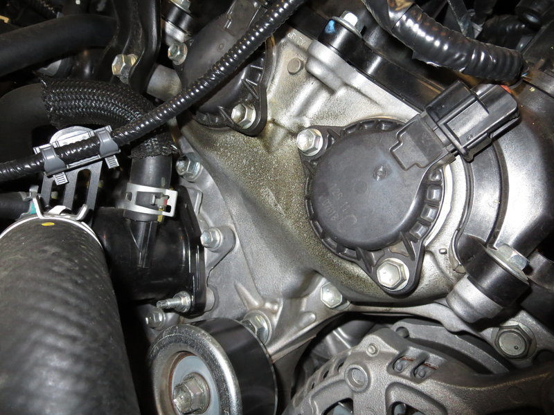

    Got the truck back today after 21 days in a rental. Here is the invoice for the warranty work they did. Talked to a tech about what exactly happened and he explained that the hole, for the bolt holding the cam sensor, was machined too far and created a pin hole through the cam journal cap.
    So anybody experiencing oil coming through the bolt hole has a machining problem, and anything other than replacing the journal cap seems to be a half fix. Putting thread sealant may stop it, but its not fixing the real issue.

    No more leaking. It is impossible for it to leak out of the sensor bolt any longer since the new journal does not have a hole created by the improper machining. Since Iv had it done I have only taken the truck too and from work, which is less than 10 miles. My only concern now is that everything holds up, new seals ect, to a prolonged beating. Will be taking truck on a 800 mile week long vacation in Baja next week. That should put enough stress on it to ensure everything is good.

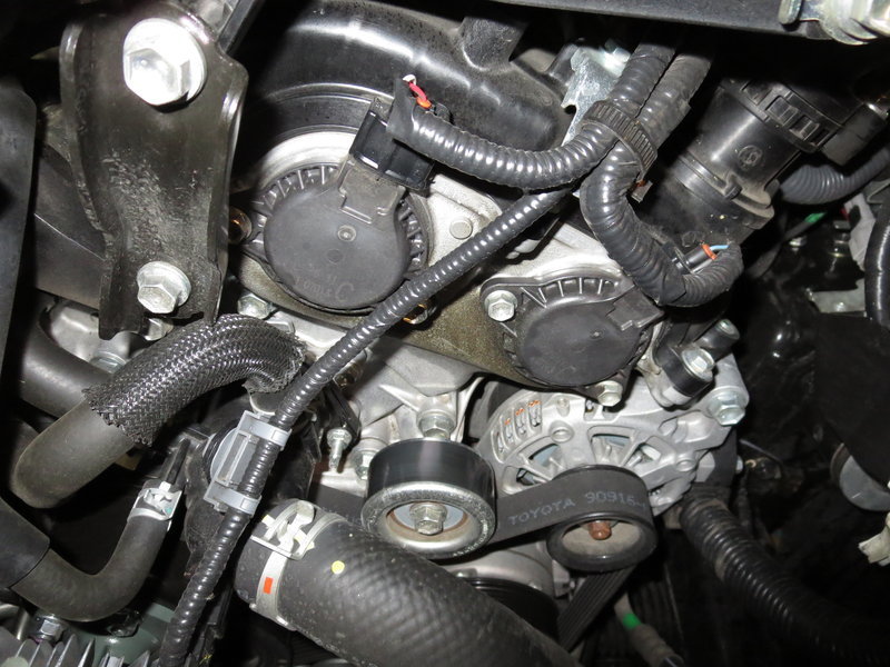

    So been on the road doing a bunch of highway miles in the taco and my leak has definitely gotten worse. Had a chance to actually look up what the cam position sensor part looks like and realized that I have a leak from one of the vvti cam phasers and not the cam position sensor. For some reason i thought the phaser and position sensor were integrated. From what I can tell it is originating from the phaser only and not the valve cover. Possibly bad thread sealer or crappy gasket. Here are some pics of what my leak looks like, haven't been able to find anyone else with this yet. Just opened a case with Toyota corporate, we'll see what they find when I take it back in.
