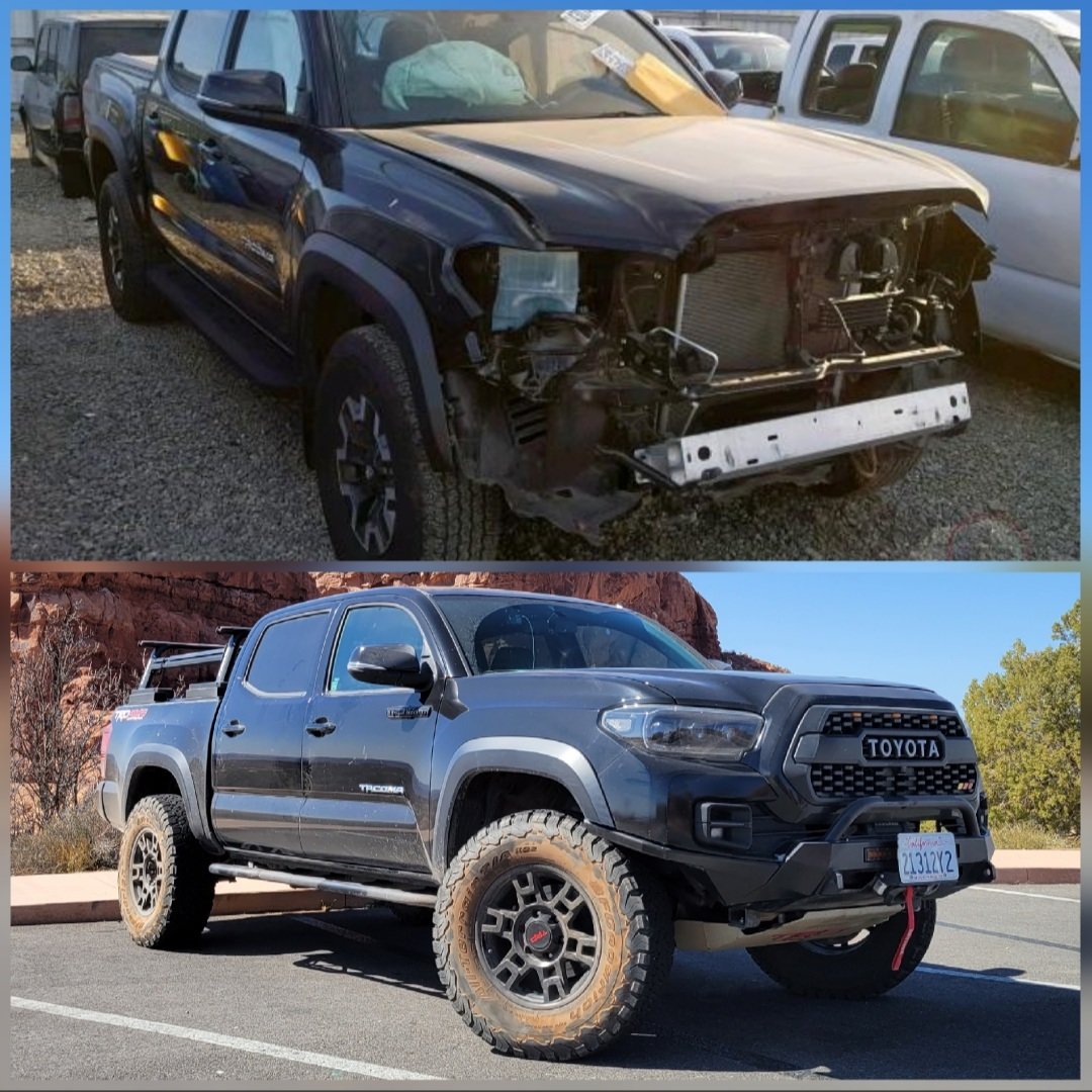

    I did a similar project a year ago. Turned out great. Congrats on the truck and getting it started.

    Woow thats a nice truck! is it the TRD or the SR5? how much do you have invested on it now? and how much you got it for? IT becomes an addiction on buying more and more parts for it right? >_<

    its TRD OR. Got it for 14g after all fee. Only had 22k miles at that time. Putting another 10g on it so far. Thats including aftermarket parts and lift.
