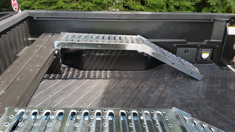

    ...^^^... I am digging that bed extender and ramp ... does it fold up ... where did you get it ?? ... :thumbsup:

    It's a ready ramp. I got it from their ebay shop. It folds flat when i store it im the garage.

    ...^^^... Thanks a lot ... it looks strong ... the folding part is cool.

    It's pretty nice, The fit and finish is top notch. The only minor gripe is that they should have added more cross beams. The way I load bikes is I have 2 ramps. One for the bike, and the other ramp for me to walk on. My other ramp (oxlite) has more cross beams which makes walking on it a piece of cake. With the ready ramp, I pretty much have to use it to load the bike only, as I don't feel comforatable walking up it pushing the bike.
    With the straps used as a tail gate extender, it's pretty secure. No issues there.

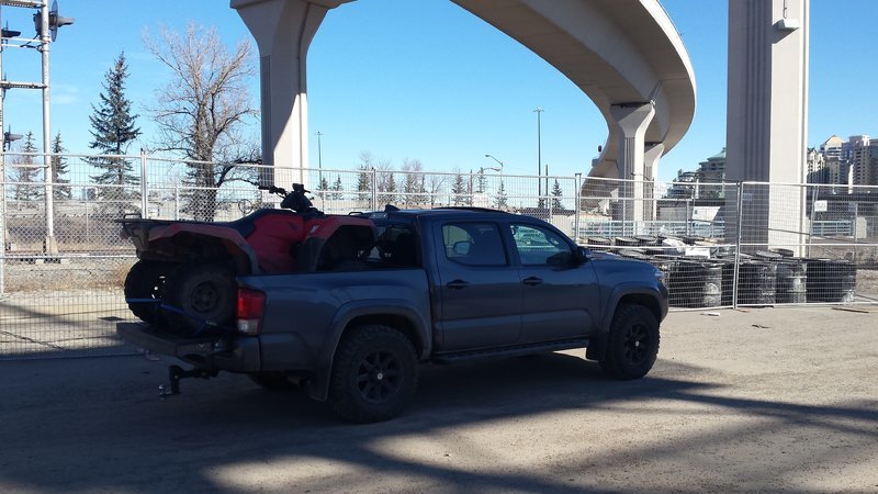

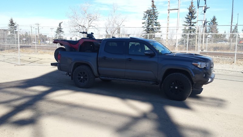

    2016 Short N Stubby Bed- MGM
    Front and Rear lifts Tires ECGS bushing Lots of other crap +HP sticker
    I was concerned about this too when I read the manual before loading a quad in back. No doubt the point loads on the very edge of tailgate would be over the 150 lbs (manual spec) or more at each ramp. I said fuck it anyways if this busts loading a quad I'm trading in my Taco lol.
    In all hoestly though if I were to look at from an engineering perspective I would look at the tensile capacity of the steel cables and I'm guessing they are in the 600 lb ++ range based on their thickness. We user 1200 ++ lb cable structurally.
    So in my opinion the tailgate metal (not sure if stamped steel or aluminum) would yield first before the cables do. If you load that SOB right in the middle of the tailgate on the very outter edge with 500 ++ lb point load suddenly you'd be have yiurself a new curved tailgate-for down force of course.... But evenly distributed I think your fine.

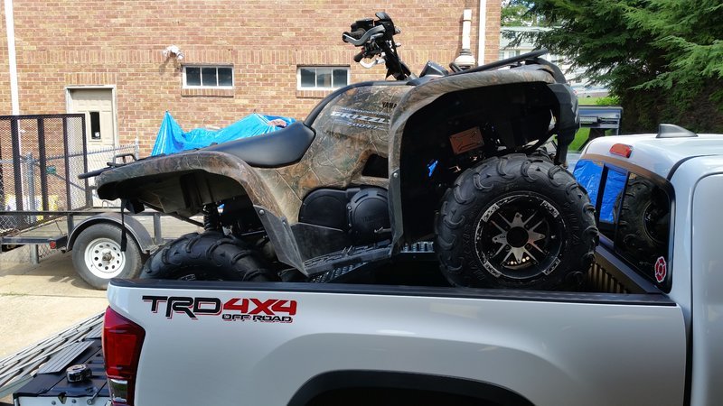

    load and carry 700 grizzly with no problems20160901_114516.jpg 20160902_133315.jpg
