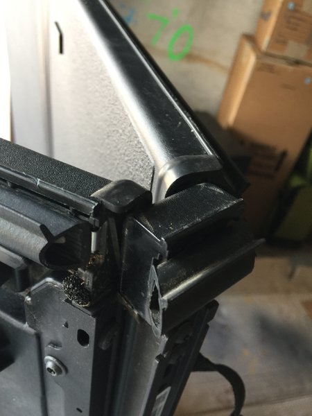

    IMG_1922.jpg It's the piece shown in the picture. It's missing on the opposite side

    Hmm, that may be tougher to identify. Any other dealers you can try?

    I feel like that specific of a part may be too hard to find. It looks like Toyota only sells each panel separately. But that's all I've seen from the consumer side.

    Might have broken off. Mines did and I super glued it back. I never noticed a part number on it.

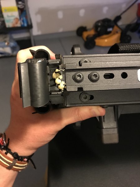

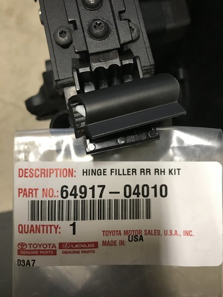

    64917-04010 - this is the shorter of the 2 (there's 2 short ones and one larger one) gasket parts that fit between each tri-fold section. I've broken 2 of them already (in 18 months)
    Got first one from the dealer no charge - 2nd one I bought from Partznet for $15
    you need screws to hold it in place part # for that is:
    64949-04080 - I think you need 2 of these.... I ordered 2... now I have an extra one from removing the old broken part.

    I figured out that the cover I purchased had both of those tabs broken. Swapped them out and good to go.

    There is a torx screw under the rubber gasket. If you pull the rubber to the side in the middle you can access it. Unscrew it and flip it over. No need to unclip the ends inside the gasket. Everything should line up again. I had to do that with one of mine to make it match the rubber.
