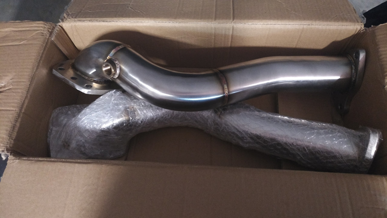

    I think this has been asked before but @OVTune do you have better pictures of the dump tubes? The ones on ovtuned.com are covered in bubble wrap, I would like to get a better look please and thank you! Also do you know the diameter of the tubing?

    I was trying to understand what the dump pipes are and how they fit into the Tacoma. Do they replace 1 and 5 in this diagram?

    They replace #1
    For people who asked, we will have a high flow catted version available in a few weeks.

    @OVTune I ordered the dump tubes on Friday. Do they include any gaskets that may be needed?
