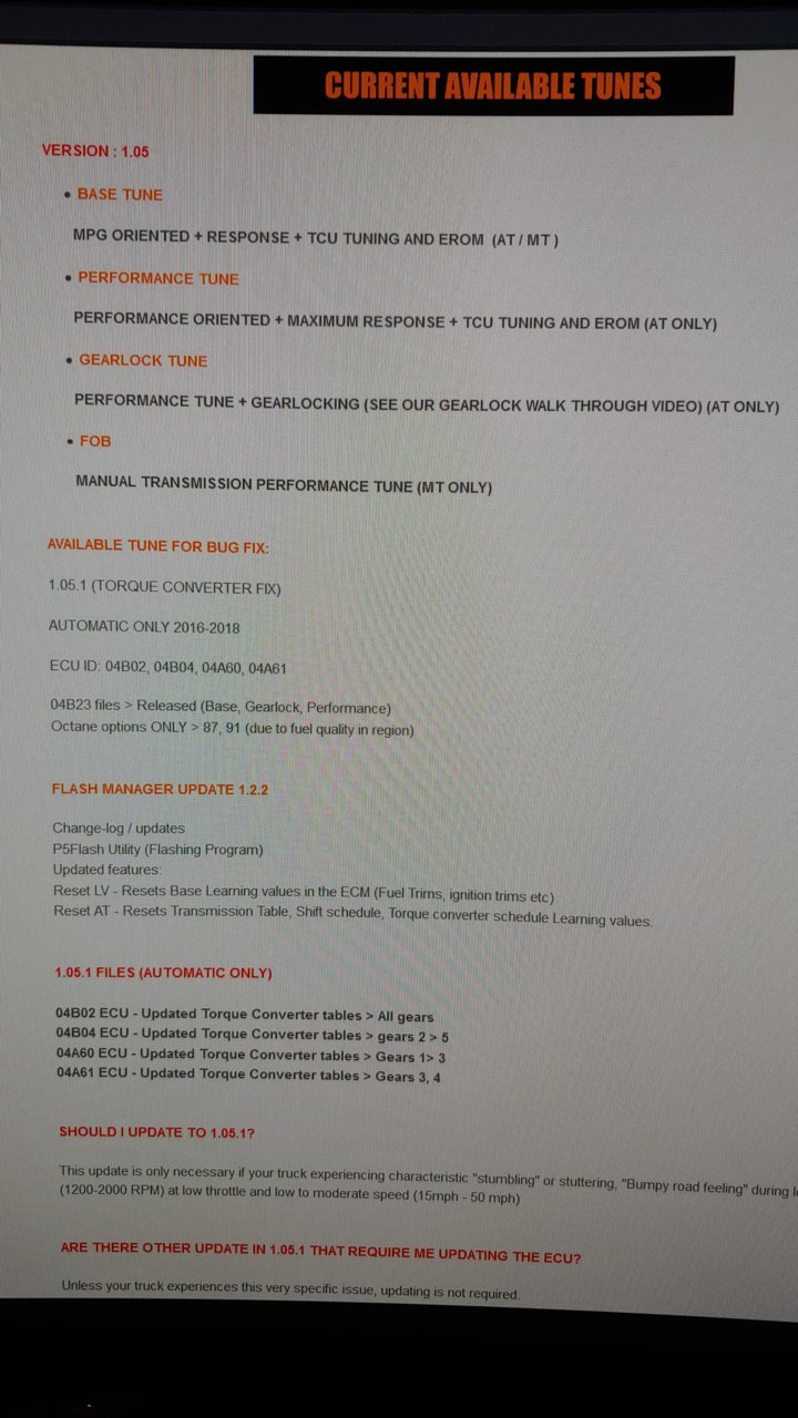

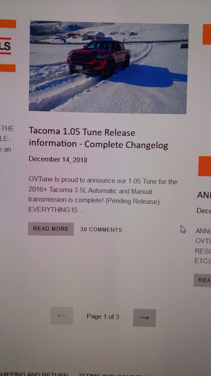

    Mat posts blogs on his site with what all he has done in an update and future development. Also under flash manager tab is a list of the currently available tunes and what trucks they are applicable to.
    This is what you were asking for right?
