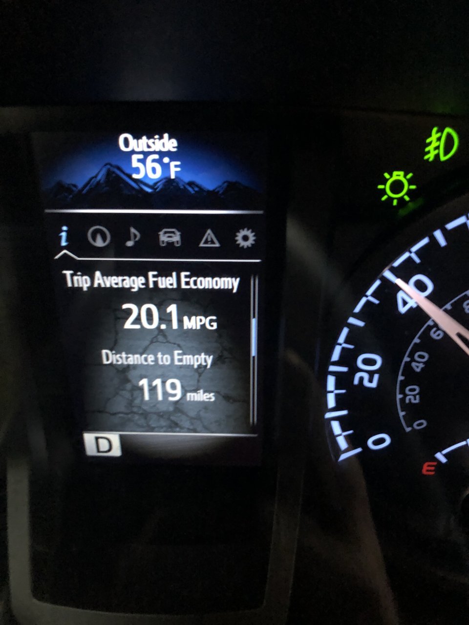

  8. Sep 1, 2019 at 3:35 AM
    go2cnavy
    go2cnavy Well-Known Member
    Sep 25, 2016
    #198172
    1,236
    ‘17 OR DCLB. VF Tuned, 5.29s, Dobinson’s MRR
    OVTuned w/ 5.29s 2” lift on Dobinson’s MRR paired with ICON RXT leaf packs. SCS RAY 10s Toyo Open Country AT III 285/70R17
    On 2.0 93 beta. 45 min drive. 40-60mph.
    I’ve never seen these numbers before. It could be the new tires, but I don’t think it is. I’m coming from 255/85R16, now on 275/70R17. They are only a few lbs lighter, but the wheels are likely a little heavier (both Ray10s).
    Yes, 2.0 makes spirited driving fun, but it also makes it easy to drive slow and smooth.

  9. Sep 1, 2019 at 5:31 AM
    OriginalMan
    OriginalMan Well-Known Member
    Apr 28, 2018
    #251976
    1,276
    Oahu 808
    2017 TRD OR 4x4
    Bilstein 5100/888; 5160/AAL; SCS Ray10 Limited Gold; 285/70 Cooper STT PRO; AVS; OVTuned; Prinsu Cabrac; RCI Bedrack; TC Bed Stiffner
    20-21mpg is what I see with the 2.0v2
    go2cnavy[QUOTED] likes this.
