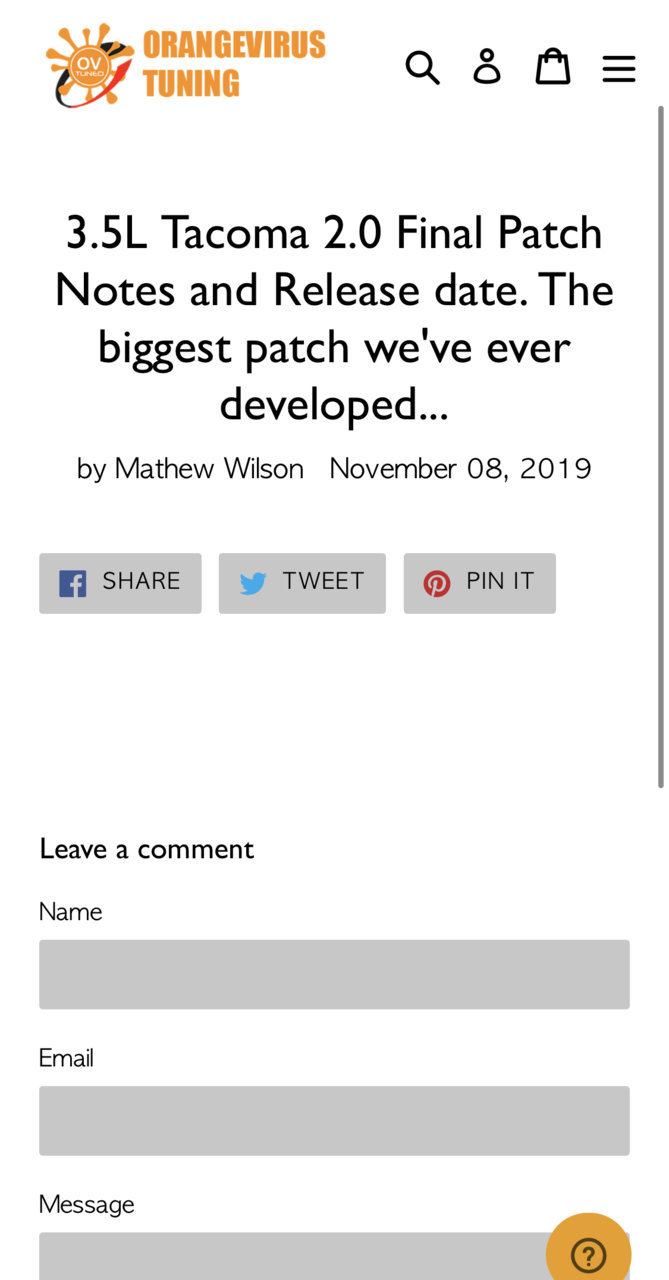

    I also find that there is a link on the blog, but no text once you click on it.

    The blog post is up, I'm taking it down and putting it back up it should show. If it doesn't refresh your browser or the page

    I just checked, only the Tundra one is showing.

    The title and stuff were up last night, my guess is something went wrong when it uploaded.

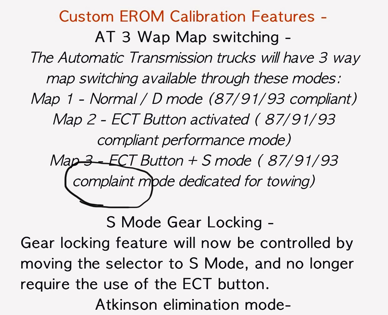

    @OVTune , looking at the different maps, what would happen if we are in S mode but don't/forget turn on ECT? I'm sure I will do this as I'm so used to switching to S mode from D. Would that be like a Map 1 gearlock? Not clear to me. And Thank You! :hattip:
    Custom EROM Calibration Features -
    AT 3 Wap Map switching -
    The Automatic Transmission trucks will have 3 way map switching available through these modes:
    Map 1 - Normal / D mode (87/91/93 compliant)
    Map 2 - ECT Button activated ( 87/91/93 compliant performance mode)
    Map 3 - ECT Button + S mode ( 87/91/93 complaint mode dedicated for towing)
    xxTacocaTxx likes this.

    Quoted from the blog:
    "S mode Gear Locking -
    Gear locking feature will now be controlled by moving the selector to S Mode, and no longer require the use of the ECT button."
