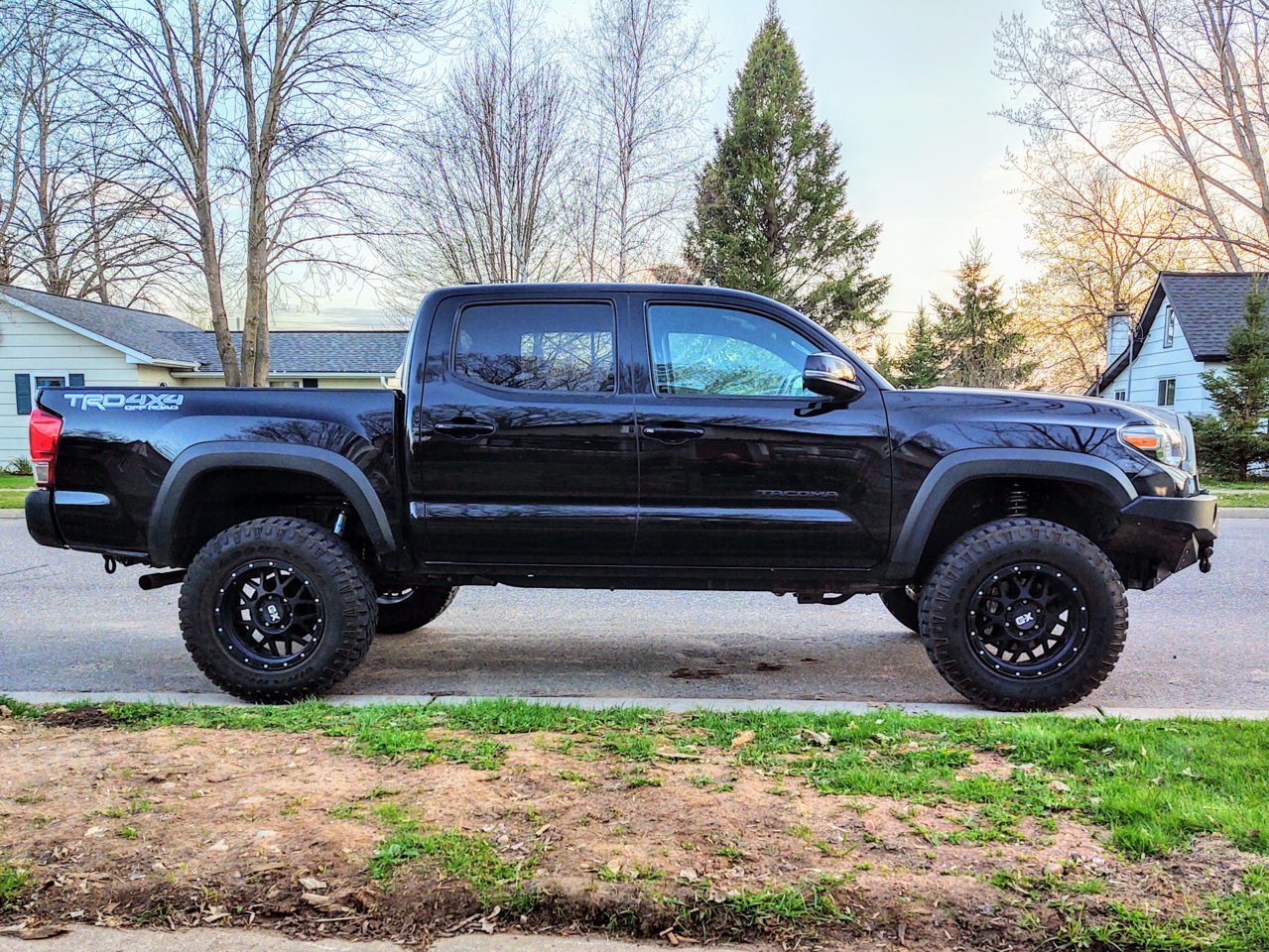

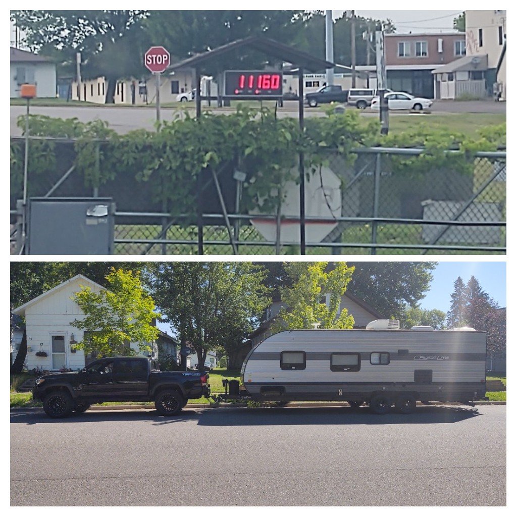

    2017 TRD OR : M+W Nexus Tuned
    Tune: Nexus +P Add ons: +3" custom suspension 295/70/18 Yokohama M/T Tires KMC XD Grenade OR wheels KN intake Blackhawk MBRP Exhaust TJM Rock Crawler Bumper Lighting (+10 H.P.)
    Forest River Cruise Lite 261 bhxl. 4750 dry? Truck is 5060# with me in it. So 6000 pounds fully loaded including H2O.

    3" suspension lift front and rear.
    275/70/18 (33*11)
    Stock gears
    Steel front bumper
    Some lighting
    Pretty basic...
    Oh! And now OVTune :D
