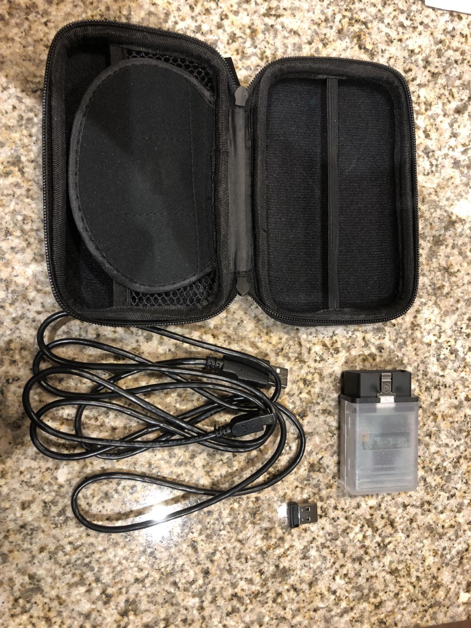

    Dongle unit for sale, first reasonable offer gets it. CAA38CE5-A44F-4BA3-891C-E8F64334F366.jpg

    I want the damn carrying case so I can store my Taxtrix cable. Lol. I keep getting it confused with the other mini USB cords and they don’t work.

    Wrap it with a zip tie. Problem solved lol or you can get a canvas bag for $5

    ....but what if I zip tied all of my USB cords? o_O
    But in all seriousness, I just want the cool OV bag. I keep the cool Dance Dance party OBD plug in connected to the cord so I know which cable is the correct one.
