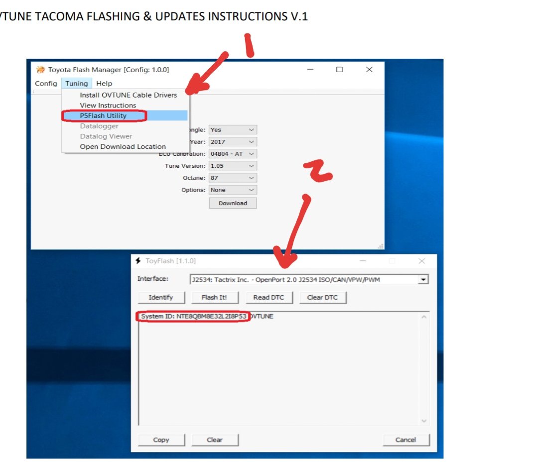

    Is "Install OVTUNE Cable Drivers" in the drop down menu the same as installing the Tactrix openport 2 drivers? I installed the Tactrix drivers a while ago and the new instructions don't mention "OVTUNE Cable Drivers" so I didn't do that one either.

    When taking foot of the gas its not supposed to downshift. And what do you mean by "2" and faster speeds?

    Just stick with the Mat's instructions. Sometimes our comments can be confusing if you just go by those. If you get stuck let us know.

    I can't remember exactly what menu it was under. I just know that when I tried to "flash it" I kept getting a failure notice.
    See #1 below... click that once you've connected your computer to the truck. If #2 is blank, you need to click #1.

    Thanks. All is good. Working as described on mine.
    (under the Tuning drop down)

    I didn’t see the driver install step either. I just took your advise and installed the driver under the tuning tab but when I open P5Flash Utility my Interface is still blank. Do I need the cables hooked up 1st?

    I believe it needs to be hooked up.

    In my experience, the p5flash interface remained blank until I hooked up the Tactrix for the first time. After that it would always display the interface whether the Tactrix was connected or not.
