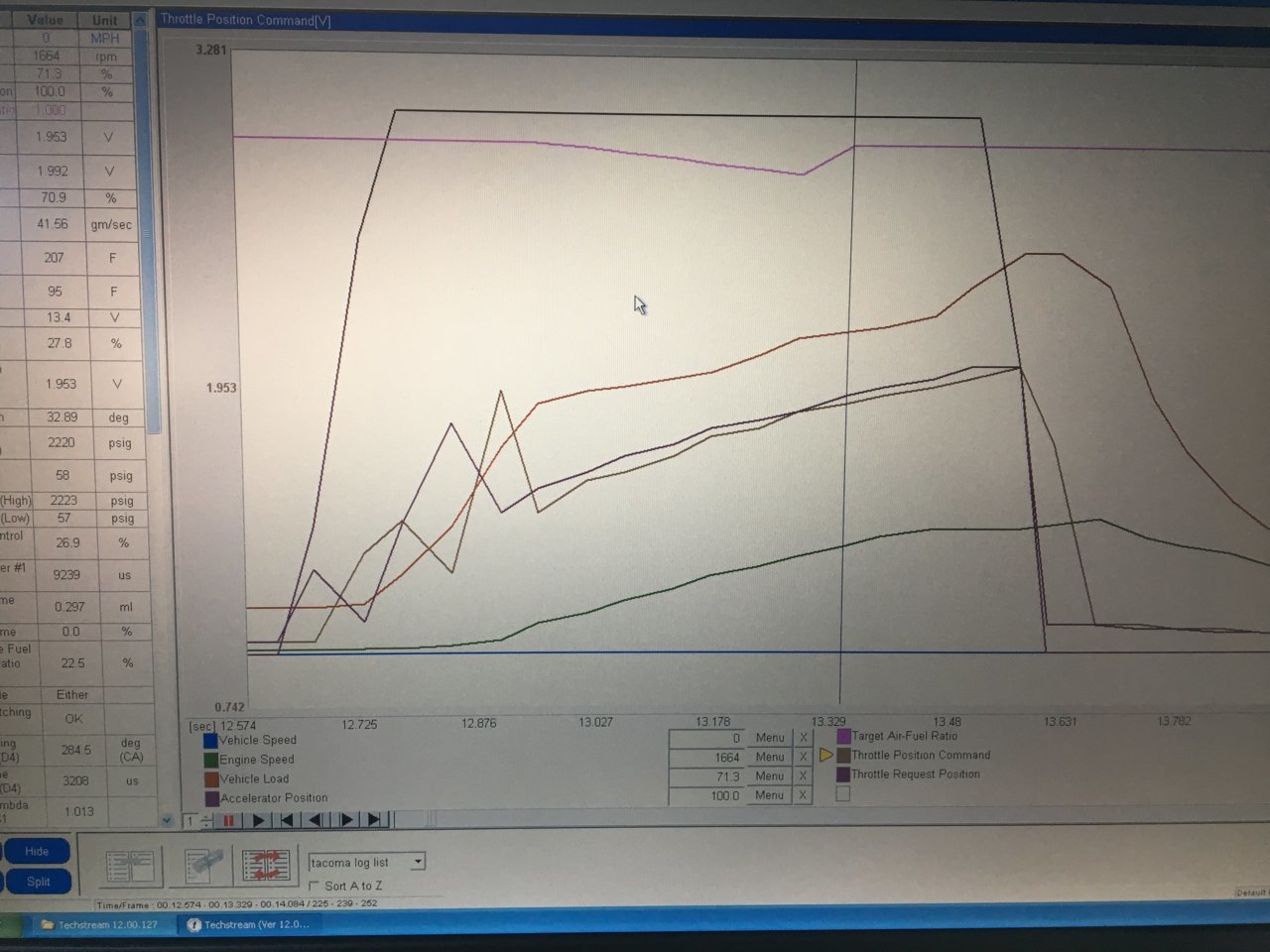

    I’ve been logging the stumble on acceleration, full throttle from a stand still, AT, engine and trans normal operating temperature.
    The top line is accelerator position.
    The brown jagged line is throttle position command.
    The purple jagged line is throttle request command.
    They are all over the place until 1000rpm.
    @OVTune
    bshammer0, hbaade and Chipi3s like this.

    Tampa, FL
    2016 Tacoma Limited 2WD AT
    OVTune
    At least it's just throttle control and not AFR, no reason to worry and should be an easy fix.

  16. Apr 9, 2018 at 8:30 AM
    PB FAB
    PB FAB Well-Known Member
    Apr 11, 2017
    #215942
    794
    2017 SR DCSB 4x4 v6
    Yes been trying to capture it. Engine warm.

    Yes I have had it since the day i bought it! Took it back to dealer twice 1st time they said they couldn't duplicate the problem. 2nd time they told me it was normal. It does seem to be more pronounced with the tune. This might be part of the next update fix.

    Good work, sir. I can feel this for sure - though I rarely WOT from a stop living in the city it isn't very apparent most of the time. I know from what Mat has said previously that throttle is intertwined with torque and load maps, so (just a layman guessing...) it seems as though perhaps the choppiness is what the ECU is doing to the throttle to maintain a linear increase in engine load/speed. He's working on this as part of the update as I understand it so hopefully you've sent your logs so he can take a gander before the big 1.03b or 1.04 or whatever the new release will be called.
    SpeySquatch likes this.
