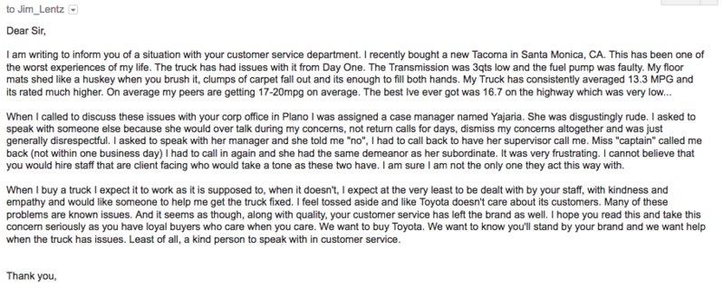

    I sent a Letter to the CEO. I found his email somewhere... I hope its correct or that was a huge waste of time
