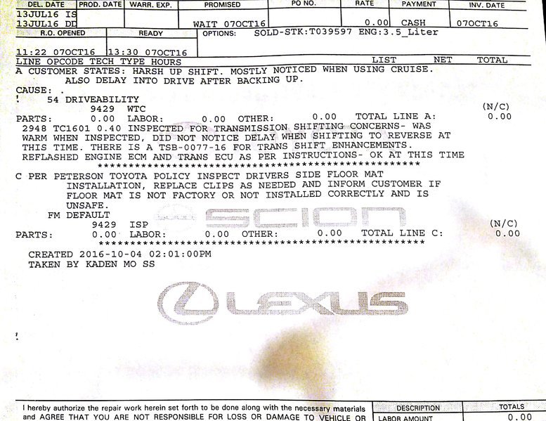

    Thank you OP and everyone for a good info. about this TSB. I dropped by at the dealership on 10/5/16 to make an appointment. I showed them the TSB-007-16 and got in on 10/7/16. Everything went smoothly, thanks for brave men and women who went in before me. They got it done in couple hours and now my truck drive so much better, and I even get better mpg. Fingers crossed, it stays this way for long time :fingerscrossed: :cheers: :amen:
