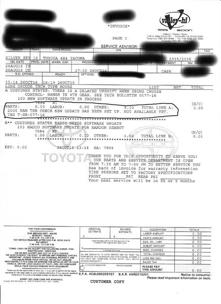

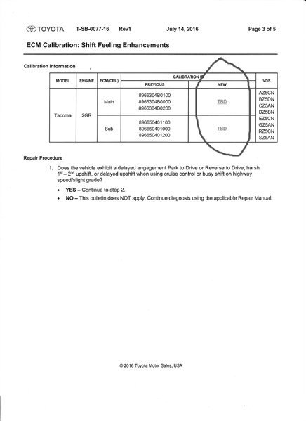

    This TSB is not available as of today and the new update is to be announced with no expected date. I had an appt for today to get it done and the dealer was surprised to see it cancelled.

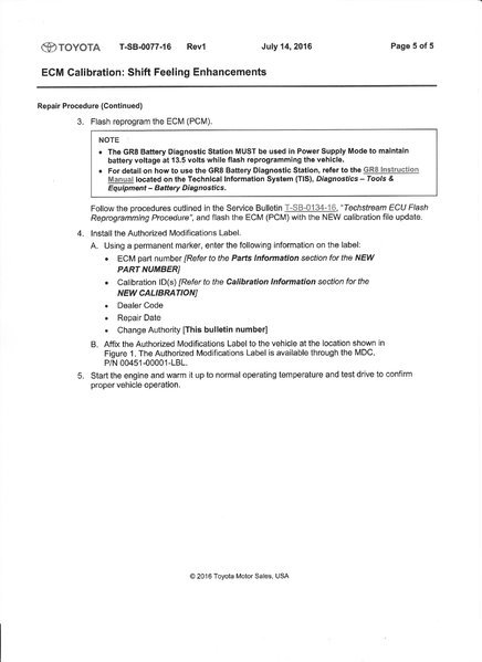

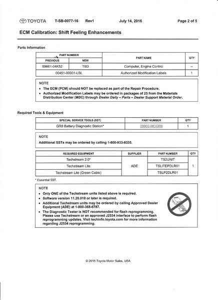

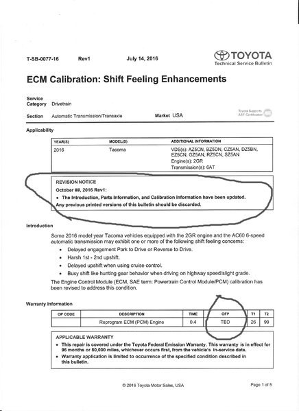

    2016 Tacoma TRD
    No it's not, I will post the revision notice in a few mins

    Bad news that it is no longer available but good news that a new one is on the way.

    Agreed but now the wait and trying to find out when it is out
