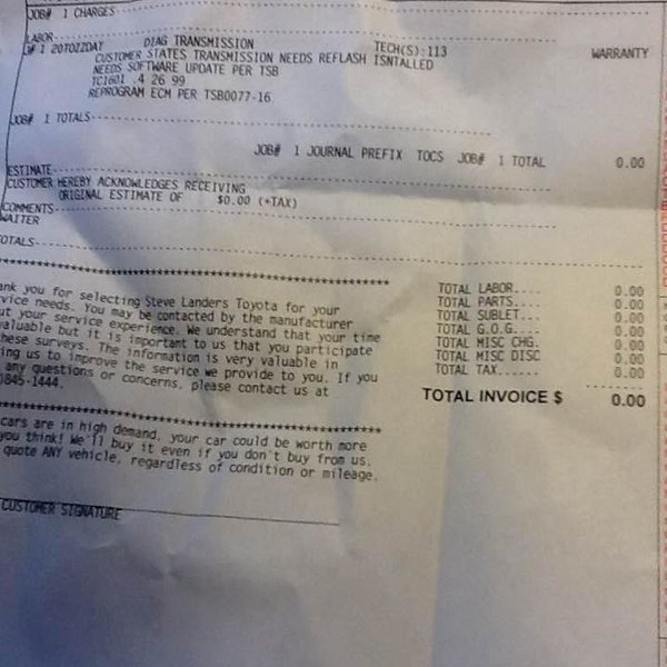

    Pat
    2016 TRD Sport
    My Toyota dealer in Fayetteville, AR fit me in today for the TSB and the truck is a lot smoother. No more delay/lurching from R to D. Thanks to OP for posting as the TSB made a significant improvement in the drivability of the truck! If you have any of the symptoms described in the TSB, i would highly encourage you to get it done!

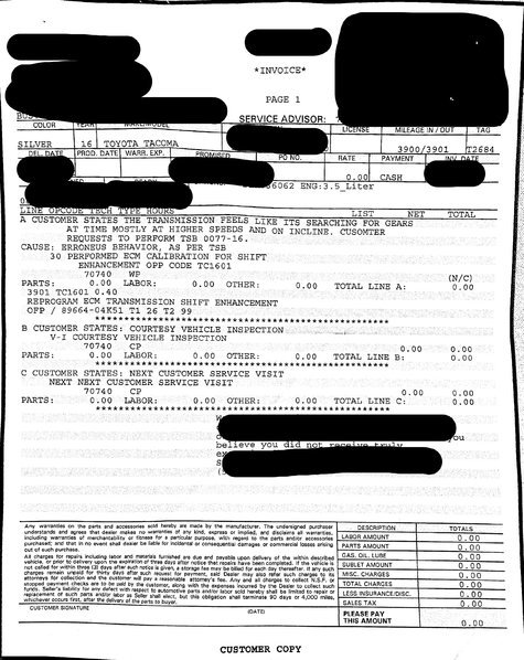

    2013 DCSB MGM
    In the works.
    The dealer begrudgingly flashed mine this morning and like others have said, this thing feels like a different truck. I can't speak to the accuracy of the truck's trip computer, but I went from averaging 20-21.5 MPG on my trip from Pinehurst, NC to Charlotte, NC to 24.7 with less high revs after cresting a hill and less downshifting from the transmission when going up them. Hopefully this lasts.
  19. Jul 16, 2016 at 6:40 PM
    #259
    4RNR
    4RNR トヨタ
    Jan 23, 2014
    #121322
    553
    Ge
    America
    16 Tundra 1UR-FE | 10 4Runner 1GR-FE | 16 2GR-FKS DCSB 4X4 - sold
    2016 Tundra crewmax
    TSB completed. All what I can say is WOW!
    Drove it for about 30 miles on the part of freeway that I would usually experience the up/down shifting.vIt shifted like it should. Very happy with update.
    Now all these negative threads can be closed, because Tacoma is Tacoma again!!!
    I always liked my truck, even with shifting issues but now I'm absolutely love it.
    Thank you TW!
    Thank you Toyota!
    Edit: Attaching work order
