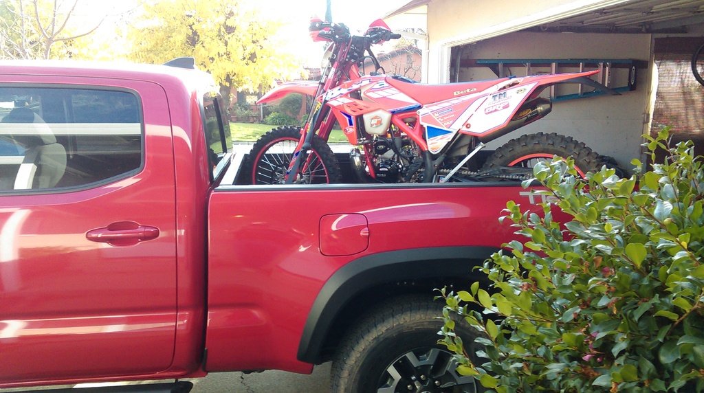

    That's funny to think back about a month and a half ago I drove an hour and a half to a dealership with my heart set on buying a 2015
    Colorado 4x4. Really sharp lookin' truck and was all rage with the on-line Mags and comparisons. I really was going to do this and while I'm driving down the highway I rec'd a call from a guy who's 16' Frontier Pro-X I had looked at a couple days before. He wanted to know
    where I stood on buying his truck (which was almost the same as my 08' Frontier Nismo w/six speed Manual Trans except his had the Crew Cab/Short Bed and I needed the long bed) Anyway, I told him I was on my way to look at and buy a Colorado and asked him his opinion on them. He chuckled and said "It's a Gentlemen's truck". So having that thought in the back of my head but still very excited
    about buying this beautiful truck with only like 29,000 miles on it, I took it for a test drive and it just didn't feel like the kind of truck that
    I could take on rugged terrain and feel comfortable. Really what my fantasy truck would be is a V6 4WD with a long bed and a six speed
    manual Trans, which is what my old truck was but it had a lot of miles. I was hoping the Tacoma offered that but the sticking point seemed to be getting a six sp manual w/long bed. So anyway, I've got a really really nice brand new truck that is so technically advanced and badassed and cool looking with 4wd, crawl control...all the bells and whistles and honestly everything I could've ever
    dreamed of in a truck except for the fact that it has an automatic transmission that I can't stand. I know, however, in time I will grow
    accustomed to it but man do I miss that stick shift and punch that the outdated Frontier had especially when I'm heading up the hill.
    Again, I have no regrets and am confident that I will get used to the auto and love it. I haven't even learned half the features yet. I've
    got a couple of the Toyota Apps on my phone, any other good ones pertaining to Tacoma's that I should download ? Man...technology
    these days is unreal. Love it.
    9a71ccf3-bb54-4f0e-ae0c-7d652a836ee3_zps_50ada04a4549edfb77fc91a1f08a6a199b327034.jpg
