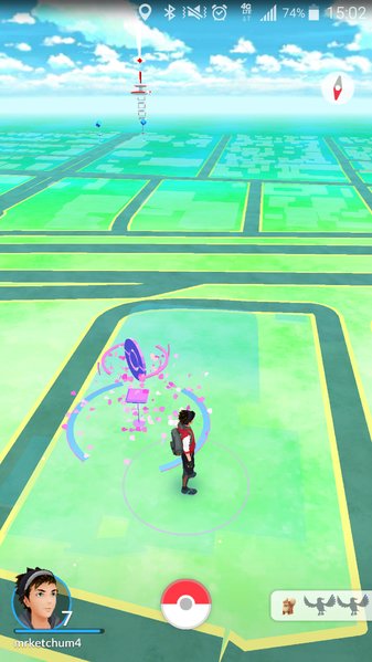

    I'm just sitting here waiting. I hope they are performing the flash. It's been a while. Somebody dropped a lure, so that's nice
