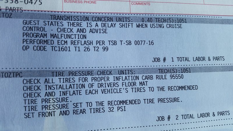

    They set your tire pressure at 32 PSI..?? What does it say on the door..? Mine says 29 lbs.

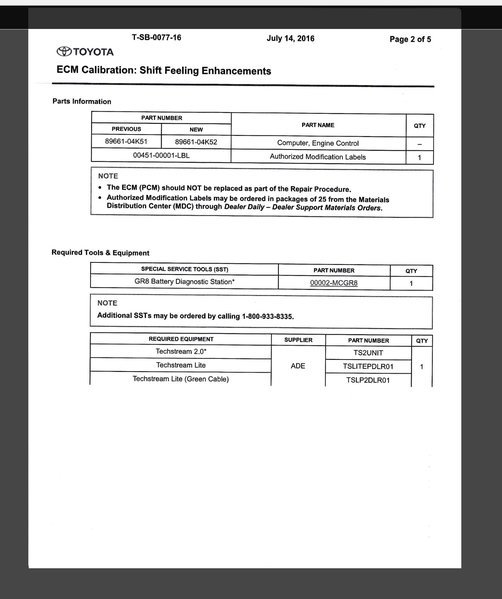

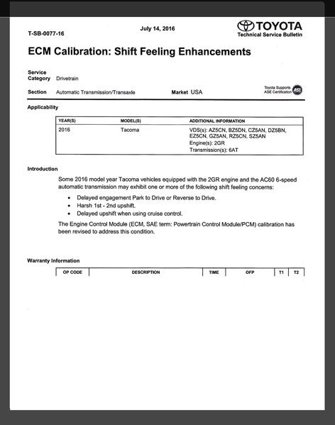

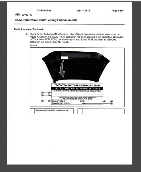

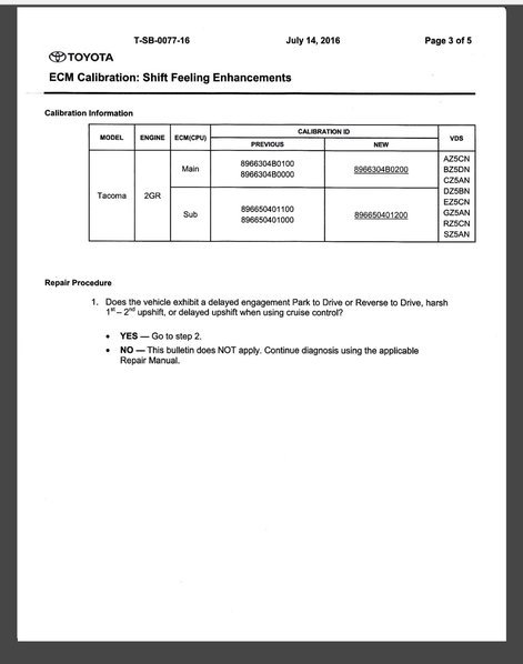

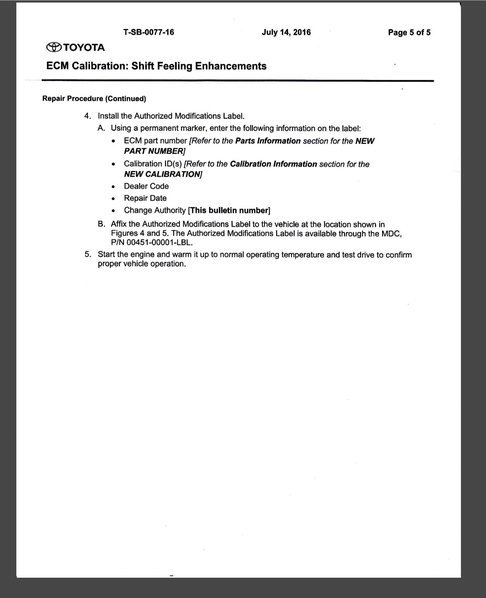

    Not sure if anyone's interested, but here's the packet that the dealership handed me today. It breaks down the Transmission TSB for the 3rd Gens. It looks to me as if some trucks already have it...check out page 4. Maybe the brand new ones are receiving the flash before leaving the factory.

    Just asked service about sticker and was told that it just goes in National Service history or whatever.

    2GR is the 3.5. Go back a couple of posts and see if your vin has one of the vin segments listed. If not then this update does not apply to your truck. Mine is a RZ5CN so its covered.

    Look at the vin numbers on the TSB if your vin has those numbers it applies if not it doesn't

    I watched them do mine, no sticker, just service history.

    I asked the guy who receives and brings vehicles in and out if they really set the pressure to 32 and he said, "I doubt it." I was going to be pissed if they dropped my pressure from 38 to 32... I checked on the dash and they were not changed. They have to pump them up to 32 for CARB compliance around here

    Update: i have the DZ5BN
